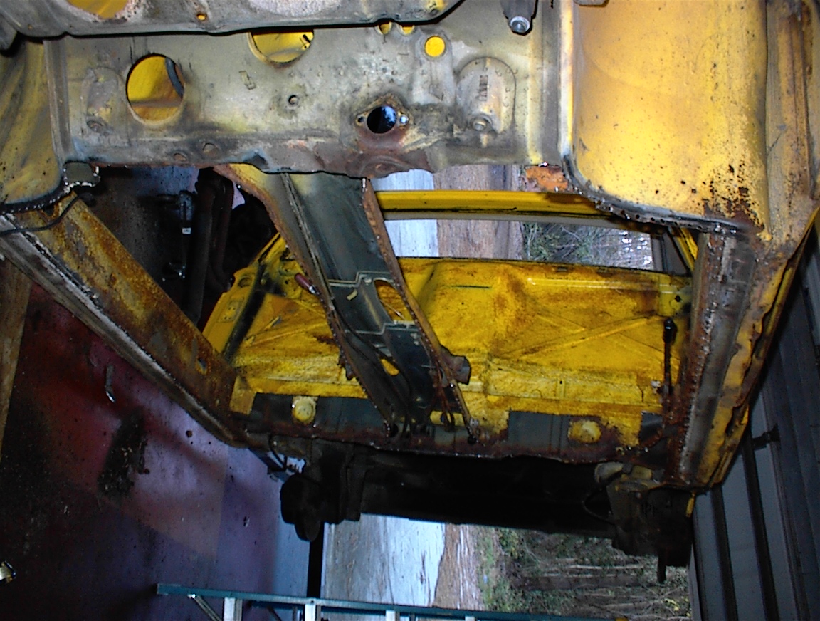

993inNC   So far this is all I can find for real damage in t...   Feb 26 2010, 01:07 PM
