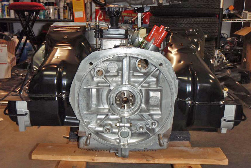

MrKona   The engine is off the stand and tin and FI compone...   Dec 27 2009, 08:01 PM
MrKona   Then the fan shroud and fan. You may want to temp...   Dec 27 2009, 08:03 PM
MrKona   Then I attached the cooling flaps and thermostat c...   Dec 27 2009, 08:11 PM
MrKona   And then the top tins! I had to remove the dis...   Dec 27 2009, 08:16 PM
MrKona   And this is where my momentum stopped... I acquire...   Dec 27 2009, 08:19 PM

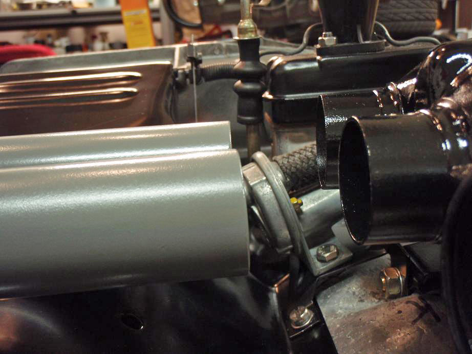

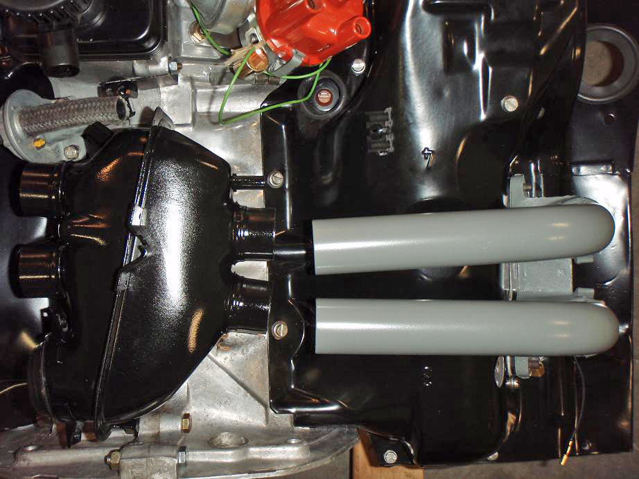

MrKona   But they don't fit the intake housing! :a...   Dec 27 2009, 08:23 PM
Cevan   But they don't fit the intake housing! :...   Feb 26 2010, 01:35 PM
Thomas J Bliznik   But they don't fit the intake housing! ...   Feb 26 2010, 01:51 PM
Thomas J Bliznik   [quote name='Cevan' post='1279461' date='Feb 26 2...   Feb 26 2010, 03:10 PM

MrKona   I'm back after having worked on "project ...   Mar 22 2010, 02:44 PM
MrKona   And one more of both runners installed.. http://w...   Mar 22 2010, 02:54 PM
