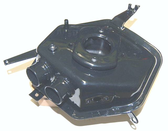

But they don't fit the intake housing! (IMG:style_emoticons/default/mad.gif)
Oh well, looks like I have to clean and paint my existing tubes, and drill an additional hole. I was hoping to make this look really clean with factory 3-stud tubes. That's it for now..

Those look like 2 liter intake runners for D-Jet FI. They won't work with an L-Jet plenum.

You need a 2.0 liter D-Jet plenum. I think I have a mint (powder coated) one off a 73. I'll look for it if your interested.

MrKona,
This is the 2.0 liter air plenum you need. Here's a photo.
Tom
