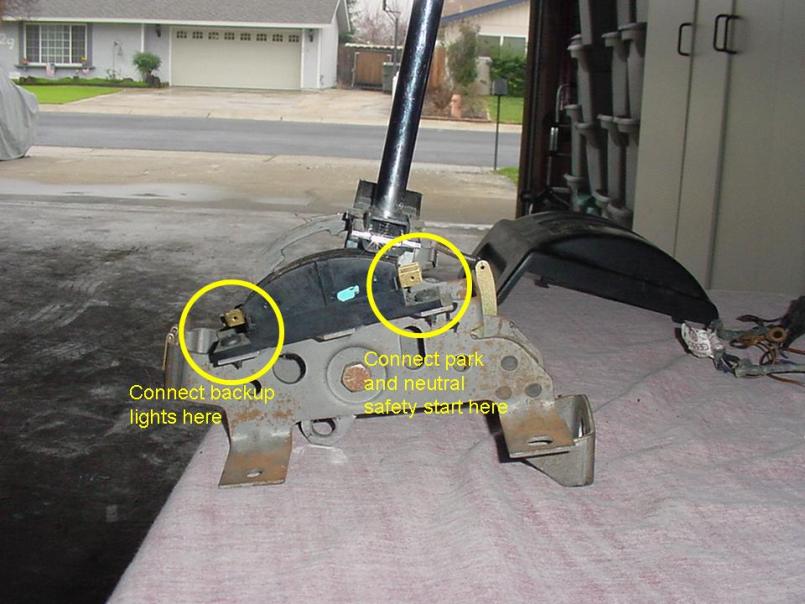

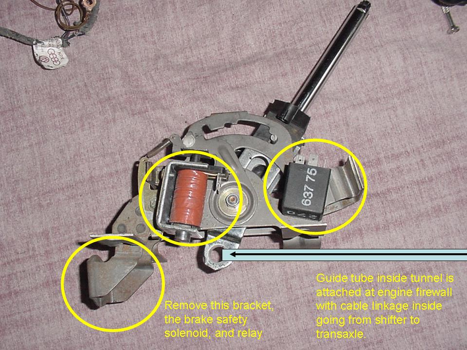

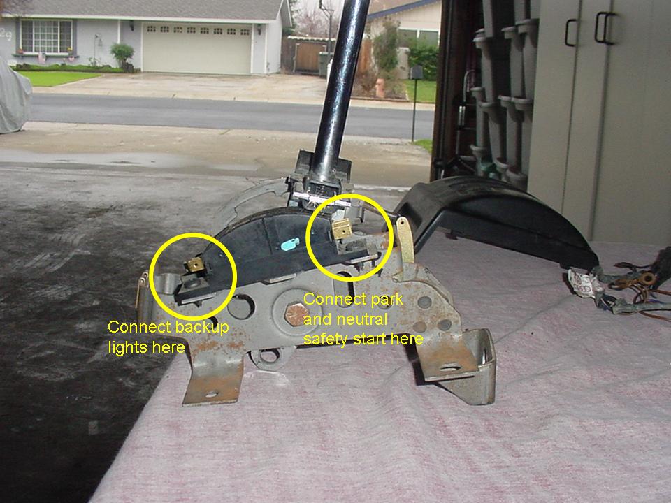

The transaxle is from an 85 Audi 5000, while the shifter they used was from a vanagon, which I never liked. I just recently had purchased an actual 85 Audi 5000 shifter from a wrecking yard because it looked like it would work much better than the tall vanagon shifter.
With some minor modification the shifter fit perfectly and works beautifully, which really has me a bit baffled why it wasn't used in the first place.
Normally the shifter would be pushing and pulling linkage going from the shifter forward to the transaxle in the Audi. By removing the guide bracket on the shifter that allows for the linkage to push and pull the same but now the linkage goes from the shifter back the transaxle towards the rear of the 914. Essentially the principal it works on is the same. All the gears hit perfectly with this setup.
The shifter now is mounted very close to the tunnel and looks like it belongs. As soon as the carpet kit arrives I'll snap a completed picture with it mounted.
