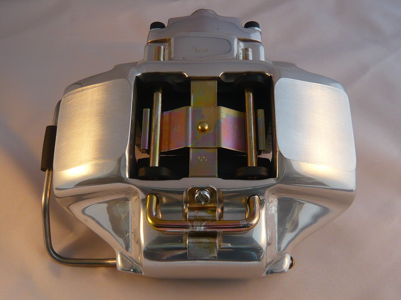

FourBlades   A picture Eric sent me today of the 908 repro cali...   Mar 6 2010, 04:48 PM
gms   A picture Eric sent me today of the 908 repro cal...   Mar 7 2010, 10:03 PM

Eric_Shea   One thing is done for this car... :D   Mar 7 2010, 10:22 AM
kg6dxn   One thing is done for this car... :D Those su...   Mar 7 2010, 11:02 AM
number6   One thing is done for this car... :D YEOWSTER...   Mar 7 2010, 08:08 PM
carr914   That's some serious PORN right there. Deserves...   Mar 7 2010, 05:53 PM
Eric_Shea   I know of another GT build that needs these... (be...   Mar 7 2010, 06:07 PM
carr914   I Don't Need No Stinkin Brakes :evilgrin: ...   Mar 7 2010, 06:17 PM
