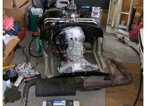

pcar916   I'm reviving this thread because I've just...   Nov 10 2011, 02:36 PM
bulitt   I have a 1949 Allis Chalmers tractor with some ori...   Nov 10 2011, 03:24 PM
