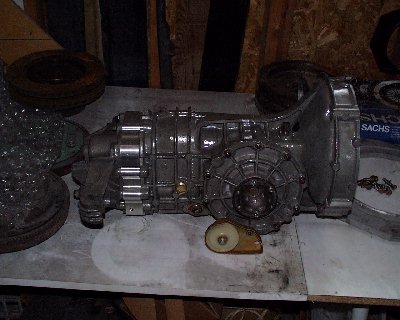

> How do YOU protect your transmission case from corrosion?, What coatings do you use?
Dr Evil
post Mar 8 2010, 10:56 PM
Send me your transmission!
Posts: 23,044
Joined: 21-November 03
From: Loveland, OH 45140
Member No.: 1,372
I am trying to finish my notes to accompany the rebuild video (notes will be free) and I am wanting to pick your collective brains for info on corrosion prevention for the mag alloy case. What do you do? The factory coating only lasted a few years and is long gone now. On most peoples cases, it is the oil that keeps it from corroding (IMG:style_emoticons/default/wink.gif)
