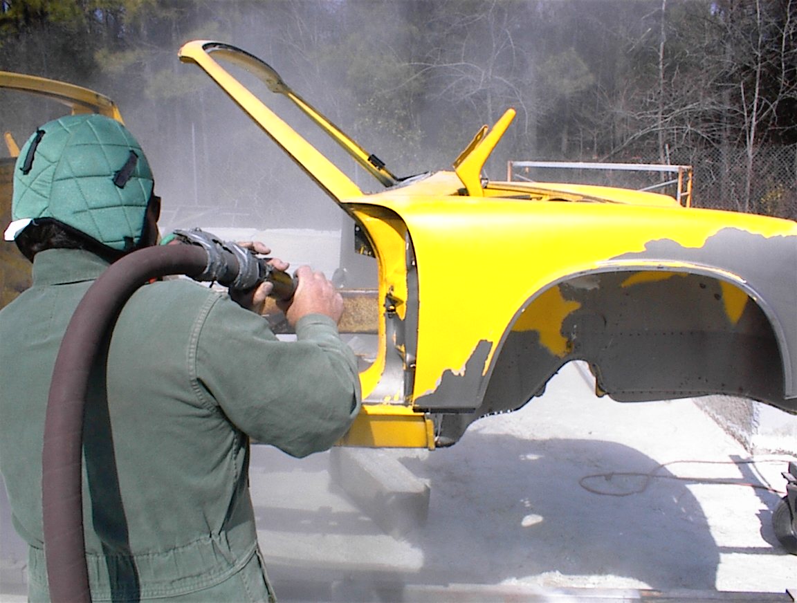

And yesterday the fun began. This was a couple hours worth of work. The blaster got the passenger side of the car done in about an hour. The car seems to be in what he calls "cherry" shape considering its age. It has however seen a few mishaps in iys past. Some idiot thought it better to bondo the entire rear quarter panel in lieu of hammer and dolly'g the dents out. That crap was like concrete coming off.....slowly!Attached ImageAttached Image

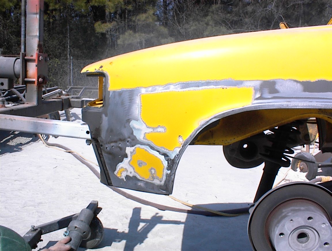

993inNC   And yesterday the fun began. This was a couple hou...   Mar 10 2010, 08:17 PM
993inNC   Was told the brass and lead we found throughout th...   Mar 10 2010, 08:20 PM
993inNC   He got quite a bit done in just a couple hours, ca...   Mar 10 2010, 08:24 PM

Jon Fernandes   Careful with the sand as it can warp body panels.   Mar 10 2010, 08:36 PM
993inNC   Yeah, I know. We're just doing very small spot...   Mar 10 2010, 08:49 PM
