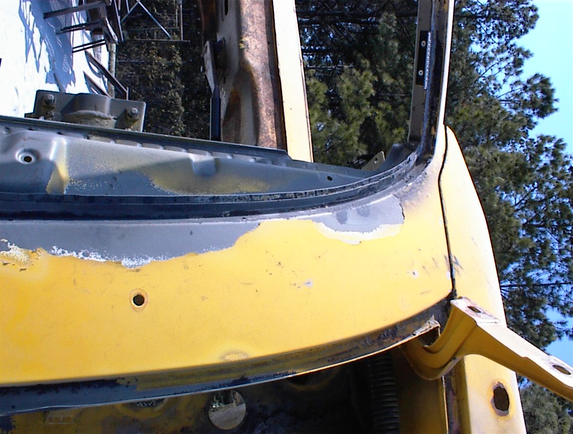

Was told the brass and lead we found throughout the car is factory original (the brass is directly under the word original and is at the front of the sill as well at the top_.
The window frame is in great shape too

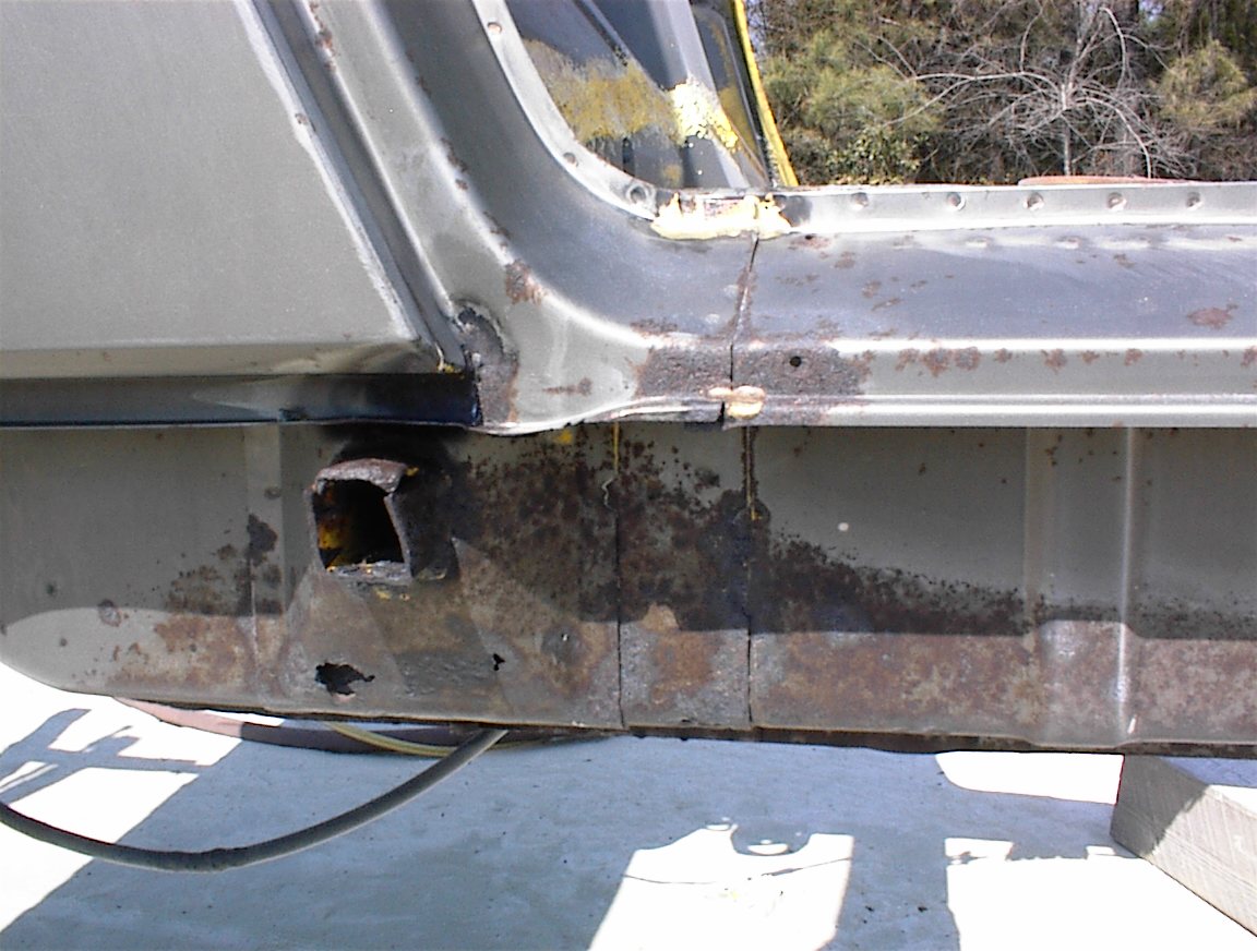

993inNC   So far this is all I can find for real damage in t...   Feb 26 2010, 01:07 PM
