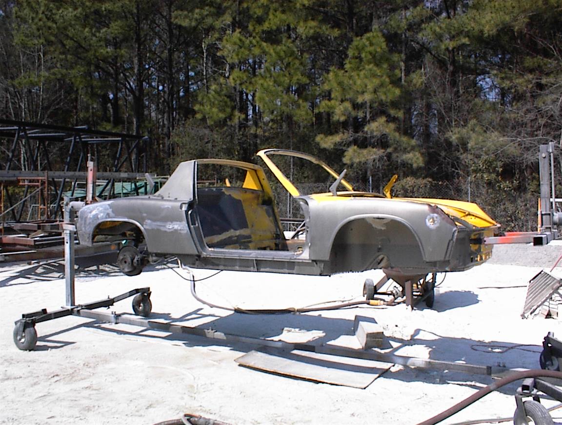

He got quite a bit done in just a couple hours, can't wait to see it complete and do a final assessment of it's condition. Sand blasting of the surface rust will commence after the soda is complete.

993inNC   He got quite a bit done in just a couple hours, ca...   Mar 10 2010, 08:24 PM

Jon Fernandes   Careful with the sand as it can warp body panels.   Mar 10 2010, 08:36 PM
993inNC   Yeah, I know. We're just doing very small spot...   Mar 10 2010, 08:49 PM
