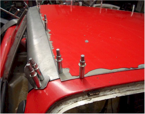

Any recommendations on how to weld the roof I am working on. I used a rear trunk lid (backwards) as it has a nice curve to it but I didn't have anyway to form the ends as one piece so I made them separate. Now I fear what is going to happen once I start welding (I will remove the paint first). I can tig or mig but was wondering if I should get a spot welder for along the door sills and across the back and tig weld across the front?

Flange the roof skin, overlap the side peices. Weld slow with lots of clamps. Weld, tap, tap, tap, to relieve stress. The flange will help to stiffen the panel and reduce any possible warpage.
Put a 90 deg flange pointing down on the front edge of the new top panel and seam weld the roof panel to the windsheild frame. Same thing,weld,tap,tap,tap to revieve stress and put the metal where it belongs.
