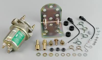

Question: Are you using a rotary style pump? If so, did you have any issues with it sucking gas out of the gas can?

QUOTE(Cevan @ Mar 15 2010, 09:51 AM) *
Yeah, I'm using one of these carter pumps:
(IMG:http://www.914world.com/bbs2/uploads_offsite/static.summitracing.com-8571-1268680822.1.jpg)
No problems pulling gas out of the can (but then it's a pretty short distance...)
