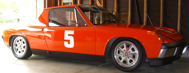

Car is to be a Daily Driver and AX car, so complete originality is not my goal. Just another nice looking car that does the job.
Similar to my last build with more of an emphasis on the street instead of track... (IMG:style_emoticons/default/smile.gif)
Body and paint is being done by the same shop that did the orange car!
