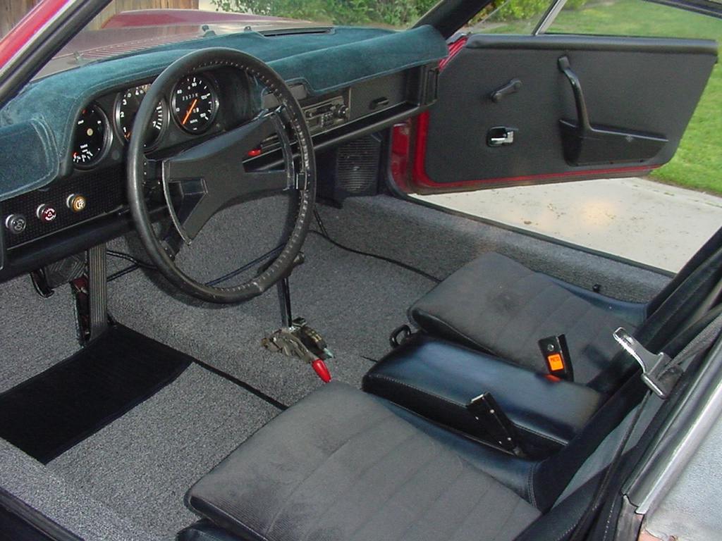

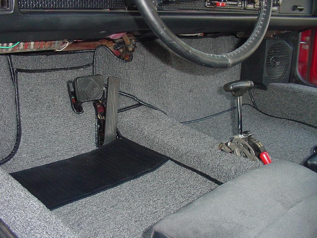

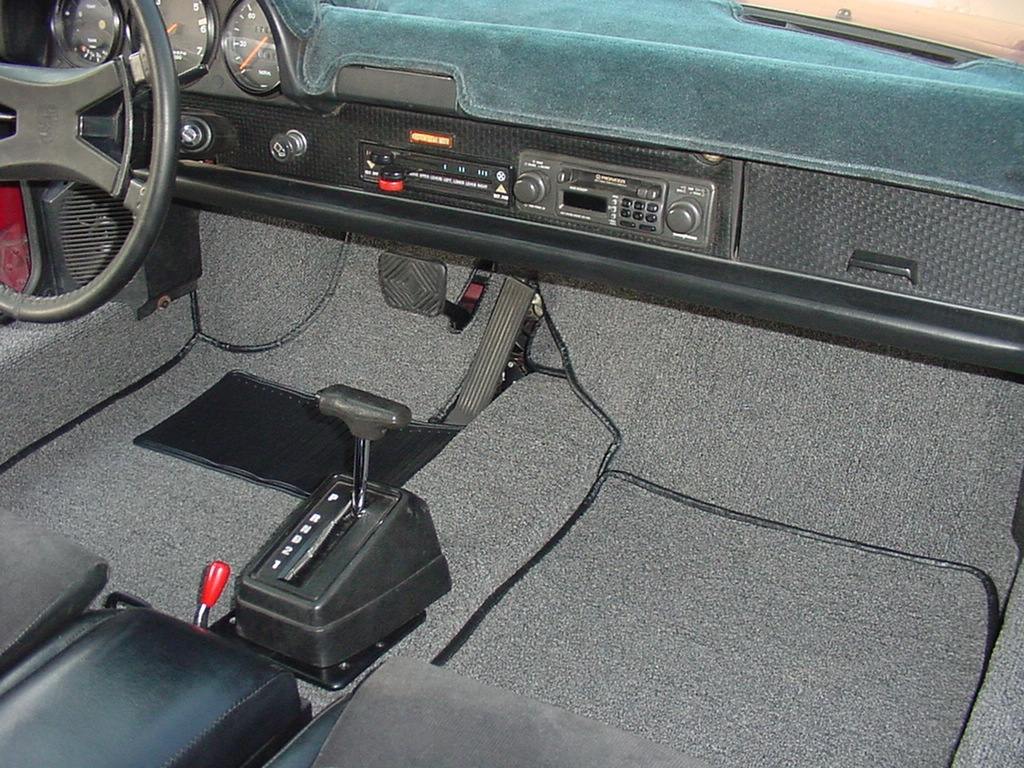

I finally had some time this week to completely give the interior a make-over. Installed the 85 Audi shifter, gutted the interior, media blasted everthing that could be refurbished, repainted, new custom carpet kit by morph, and new seals where appropriate. I'm very please with how well it all cleaned-up and shifts beautifully. (IMG:style_emoticons/default/piratenanner.gif) You can see how the Audi shifter fits perfectly in the 914 tunnel. I tried a 930 boot just for fun but it's a bit to tight to go over the mechanism. Anyway, whether I have a boot made or stay with the plastic cover, the interior is done. I also added a combo gauge in the dash.

computers4kids   I decided to go ahead and clean-up the look of the...   Dec 12 2009, 04:12 PM
Rico Suave   Why don't you have an uphostery shop make a le...   Dec 12 2009, 08:21 PM

computers4kids   After not being able to find a suitable shifter re...   Dec 25 2009, 12:04 AM
kg6dxn   Looks much better. I like it!   Dec 25 2009, 12:22 AM
JRust   Very nicely done Mark. That looks much better. Sti...   Dec 25 2009, 01:30 PM
computers4kids   Very nicely done Mark. That looks much better. St...   Dec 25 2009, 02:42 PM

computers4kids   I finally had some time this week to completely gi...   Mar 18 2010, 10:26 PM
Andyrew   Looks fantastic!!!   Mar 18 2010, 10:29 PM
markb   Nice job, Mark!   Mar 18 2010, 10:39 PM
Coy   That interior looks great!   Mar 20 2010, 12:04 PM
messix   please throw that plastic thing in the garbage. t...   Mar 20 2010, 12:23 PM
computers4kids   please throw that plastic thing in the garbage. ...   Apr 4 2010, 06:32 PM
kwales   That new shifter looks great. A smaller plastic...   Mar 20 2010, 04:49 PM
Jacob   That shifter looks so much better!   Mar 20 2010, 05:16 PM
Rand   Oh man, SOOOO much better, but yet just not quite ...   Mar 20 2010, 09:22 PM
