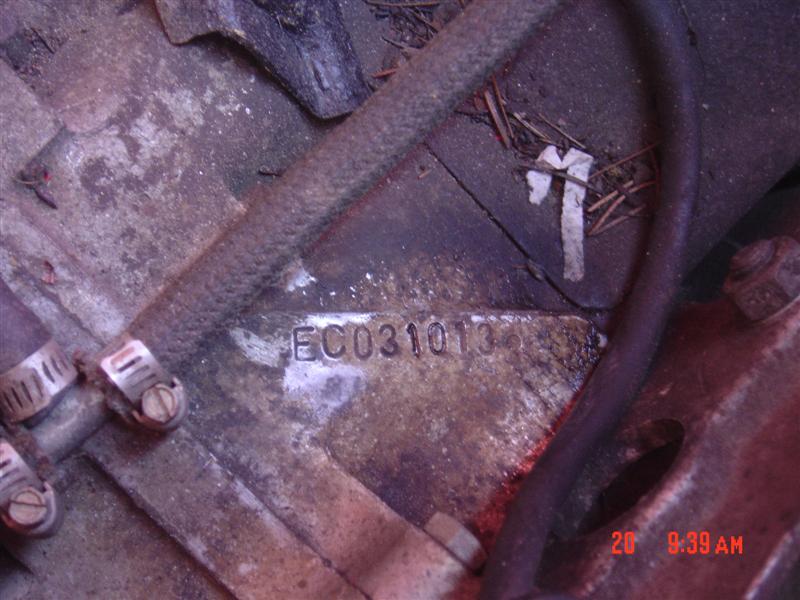

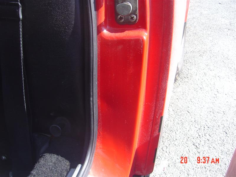

Mo pics FWIW. Trans appears to me to be a tail that has been converted, but Mike or some others will know better when I can get a good pic of it. It has the rear " extension " where the tail shift linkage goes, but all the linkage is side shift. Fog switch...no lights.......NO numbers on door jamb areas, windshield and front trunk do matchh, and front trunk does not appear to have been removed at any point. Silver dot gauges, no dash vents, early seat belts etc. etc. etc.

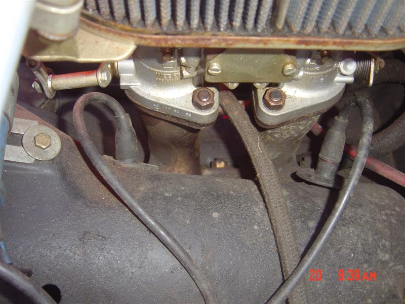

mepstein   Car is a '74 2.0 that was restored in '85 ...   Mar 18 2010, 04:31 PM
SirAndy   Car is a '74 2.0 that was restored in '85...   Mar 18 2010, 04:56 PM

bigkensteele   Mark, your dash is missing its cracks.   Mar 18 2010, 07:18 PM

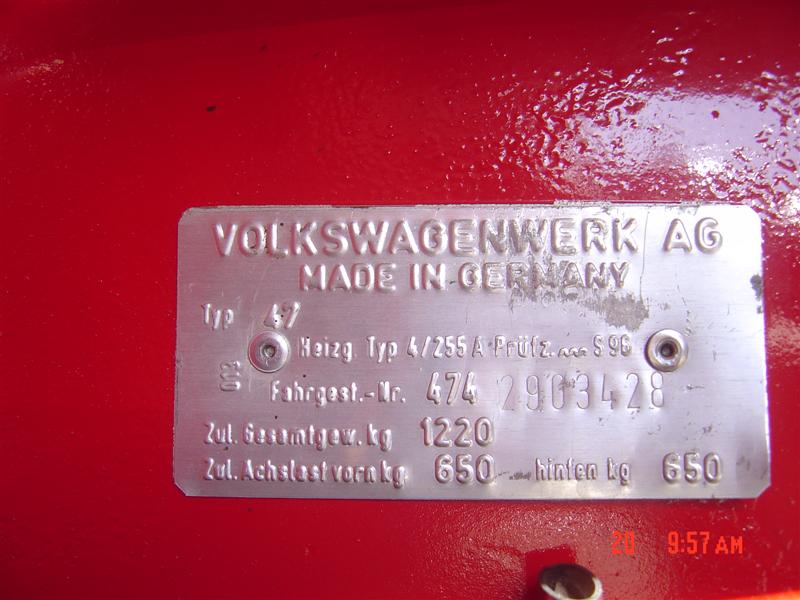

mepstein   I'm sort of shocked. Title says 1974. It's...   Mar 18 2010, 09:40 PM
kg6dxn   I'm sort of shocked. Title says 1974. It...   Mar 18 2010, 09:48 PM
markb   It looks like early seat belts.....   Mar 18 2010, 10:10 PM
bigkensteele   Not sure when they switched to the late dash with ...   Mar 18 2010, 10:28 PM
mepstein   It doesn't have retractable belts. Question is...   Mar 18 2010, 10:39 PM
bigkensteele   Car was restored at Carranza racing in NJ. This...   Mar 18 2010, 10:48 PM

mepstein   I have the title in hand. Lists as a 74 with vin 4...   Mar 19 2010, 08:25 PM
scotty b   Nope, engine is a 1.8 block with 40 IDAs on it. :...   Mar 19 2010, 08:32 PM

mepstein   Wow... I know when I had it built it was supposed ...   Mar 19 2010, 08:48 PM
Dr Evil   I have a side core I can build for you. PM me and ...   Mar 19 2010, 09:08 PM
mepstein   I have a side core I can build for you. PM me and...   Mar 19 2010, 09:48 PM
al weidman   Sounds like maybe the guy in NJ got mixed up and g...   Mar 19 2010, 09:29 PM
mepstein   Sounds like maybe the guy in NJ got mixed up and ...   Mar 19 2010, 10:08 PM

Steve   A 1.8 is just bigger pistons and cylinders on a 1....   Mar 20 2010, 09:23 AM
mepstein   Just got off the phone with Scott. He said it had ...   Mar 20 2010, 11:13 AM
ghuff   Just got off the phone with Scott. He said it had...   Mar 20 2010, 11:53 AM
