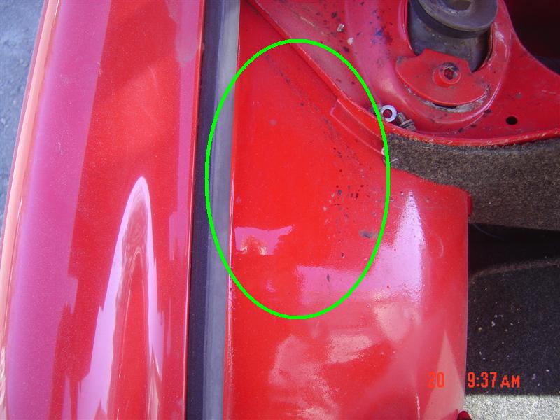

mepstein   I knew the tank would be bad. 20 years of sitting ...   Mar 20 2010, 12:46 PM
ghuff   I knew the tank would be bad. 20 years of sitting...   Mar 20 2010, 01:02 PM
dr914@autoatlanta.com   I knew the tank would be bad. 20 years of sitting...   Mar 20 2010, 01:11 PM
mepstein   Thanks for looking it over with a trained eye. I k...   Mar 20 2010, 02:06 PM

mepstein   Start digging... we've got to figure this one...   Mar 22 2010, 11:01 AM

Root_Werks   I had a 914 once years ago that had differnt VIN...   Mar 22 2010, 10:53 AM
Eric_Shea   Too bad... I just threw away a set of late model s...   Mar 22 2010, 01:00 PM
tat2dphreak   Too bad... I just threw away a set of late model ...   Mar 22 2010, 01:26 PM
mepstein   Too bad... I just threw away a set of late model ...   Mar 22 2010, 01:42 PM
RobW   :popcorn: :popcorn: :popcorn: grind that fende...   Mar 22 2010, 01:19 PM
SirAndy   Isn't the vin often written on the back of th...   Mar 22 2010, 01:27 PM
tat2dphreak   yes, it was a joke. meant purely in jest, punctu...   Mar 22 2010, 03:42 PM
jmill   I also seriously doubt it was stolen. I believe y...   Mar 22 2010, 03:53 PM
mepstein   I also seriously doubt it was stolen. I believe ...   Mar 22 2010, 09:59 PM
gothspeed   All this clearly says this example is ripe for a s...   Mar 22 2010, 03:54 PM
Eric_Shea   You should be fine. Grab Waynes' late model...   Mar 22 2010, 03:56 PM
mepstein   You should be fine. Grab Waynes' late mode...   Mar 22 2010, 04:29 PM
Eric_Shea   No. ;)   Mar 22 2010, 06:22 PM
