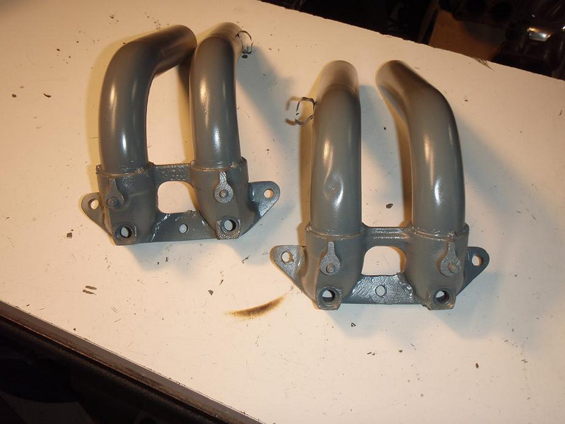

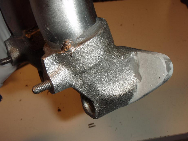

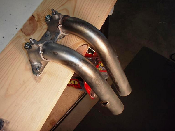

I'm back after having worked on "project intake runner conversion."

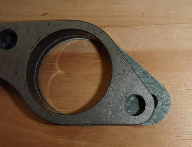

When we last left off, I had realized that my 2.0 3-hole intake runners would not fit my L-jet plenum. Since the D-jet plenum appears to require the 2.0 D-jet air filter and related pieces, I decided to drill my 4-hole L-jet intake runners to 3 holes. Easy enough, except after further inspection, I realized that it was not this simple, as there is a size mismatch between the base of the two runners where they meet up with the cylinder head. Demonstrated here by comparing the gaskets:
(IMG:http://www.914world.com/bbs2/uploads_offsite/rosalindapetrisko.smugmug.com-4469-1269290673.1.jpg)

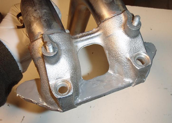

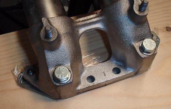

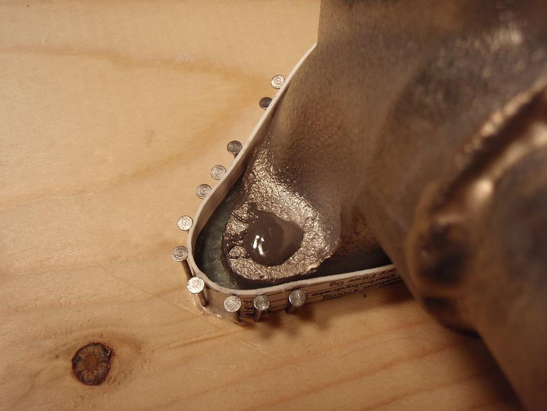

I could simply drill the holes, but cosmetically, this wasn't okay. This is where J-B Weld comes in. Using the 3-hole gaskets as templates, I created a mold to mimic the look of a 3-hole intake.
(IMG:http://www.914world.com/bbs2/uploads_offsite/rosalindapetrisko.smugmug.com-4469-1269290673.2.jpg)
(IMG:http://www.914world.com/bbs2/uploads_offsite/rosalindapetrisko.smugmug.com-4469-1269290673.3.jpg)
(IMG:http://www.914world.com/bbs2/uploads_offsite/rosalindapetrisko.smugmug.com-4469-1269290673.4.jpg)

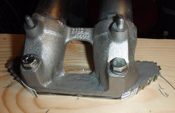

First, I filled in the existing holes:
(IMG:http://www.914world.com/bbs2/uploads_offsite/rosalindapetrisko.smugmug.com-4469-1269290673.5.jpg)
And then the rest:
(IMG:http://www.914world.com/bbs2/uploads_offsite/rosalindapetrisko.smugmug.com-4469-1269290673.6.jpg)
Removed from the mold:
(IMG:http://www.914world.com/bbs2/uploads_offsite/rosalindapetrisko.smugmug.com-4469-1269290673.7.jpg)
And sanded smooth:
(IMG:http://www.914world.com/bbs2/uploads_offsite/rosalindapetrisko.smugmug.com-4469-1269290673.8.jpg)

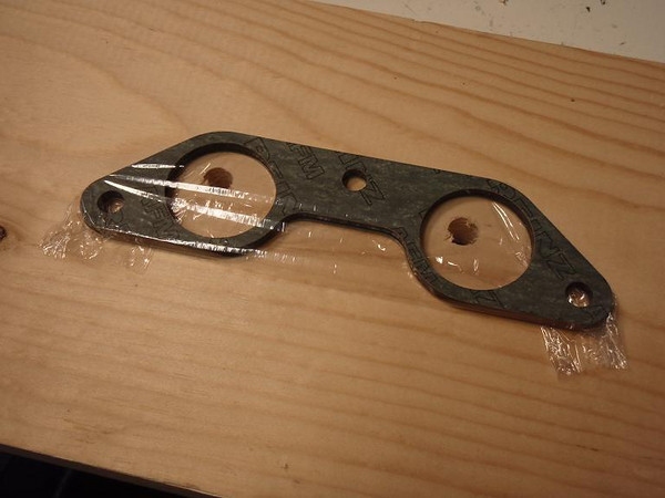

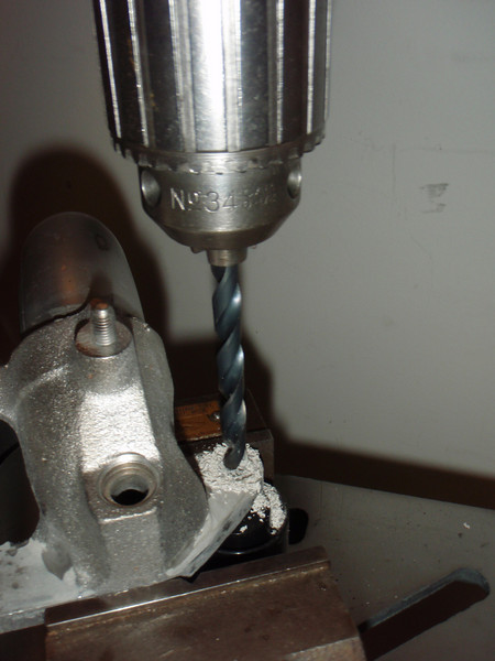

I then drilled the new holes:
(IMG:http://www.914world.com/bbs2/uploads_offsite/rosalindapetrisko.smugmug.com-4469-1269290674.9.jpg)
What is not shown here is that I eventually used a template as a "drill bit guide." I drilled the 3-hole stud pattern onto a 1/4" steel plate. It was necessary to use the 1/4" steel plate to guide the drill bit. Even with a drill press and the runner clamped onto the table, the drill press bit wanted to drift to the softer material, in this case, J-B Weld, where the hole being drilled was half on J-B Weld and half on steel. It was the most difficult part of this project.

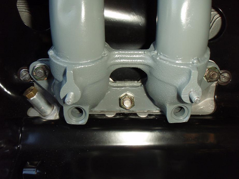

After paint, the final result:
(IMG:http://www.914world.com/bbs2/uploads_offsite/rosalindapetrisko.smugmug.com-4469-1269290674.10.jpg)

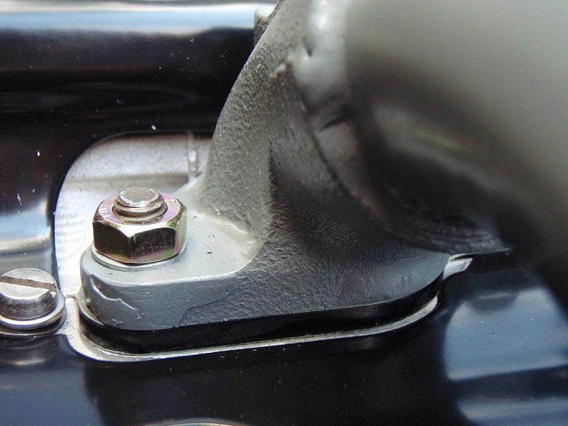

and installed:
(IMG:http://www.914world.com/bbs2/uploads_offsite/rosalindapetrisko.smugmug.com-4469-1269290674.11.jpg)
(IMG:http://www.914world.com/bbs2/uploads_offsite/rosalindapetrisko.smugmug.com-4469-1269290674.12.jpg)

1. J-B Weld is rated up to a constant 500 degrees F, so hopefully, it will be okay for this application.
2. I thin the J-B Weld with a little acetone to make it pour easier into the mold.

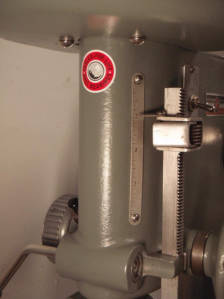

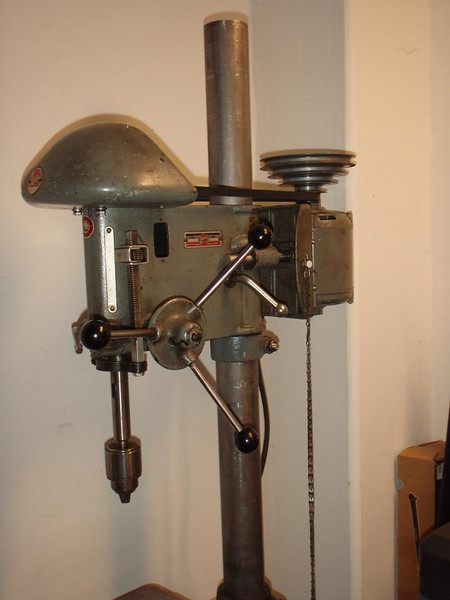

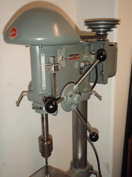

Even recreated the decal. CW for drill presses: (IMG:style_emoticons/default/biggrin.gif)
(IMG:http://www.914world.com/bbs2/uploads_offsite/rosalindapetrisko.smugmug.com-4469-1269290674.15.jpg)
