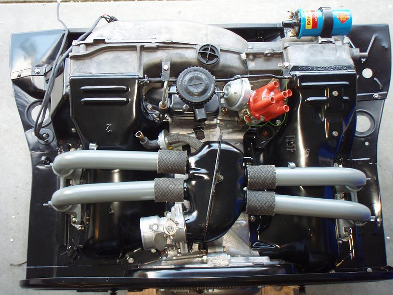

And one more of both runners installed..
(IMG:http://www.914world.com/bbs2/uploads_offsite/rosalindapetrisko.smugmug.com-4469-1269291274.1.jpg)
The beauty of this project is that it allowed me to use 2.0 three stud cylinder heads and an L-jet plenum, while maintaining a stock look between the intake runners and plenum. No need for non-stock radiator hoses to bridge the gap.
