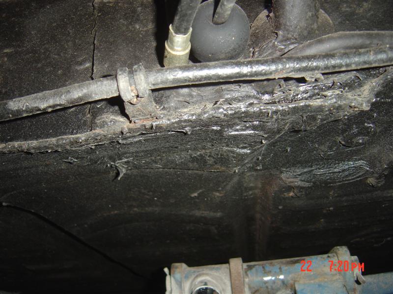

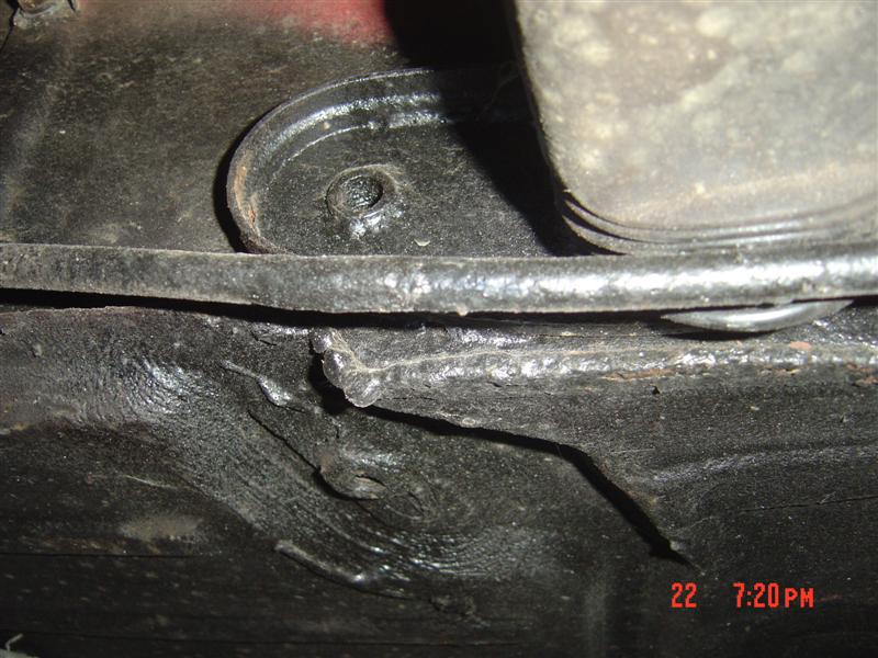

scotty b   Mo pics FWIW. Trans appears to me to be a tail tha...   Mar 21 2010, 06:19 PM

jmill   That may be an aftermarket sway bar. I have a ...   Mar 21 2010, 06:34 PM
mepstein   That may be an aftermarket sway bar. I have a...   Mar 21 2010, 06:45 PM
scotty b   Not sure about the fender vin. It appears to have ...   Mar 21 2010, 06:37 PM

jmill   This is a pic form the originality forum. It...   Mar 21 2010, 06:44 PM
scotty b   OOOOHHHhhhh yeah. Me forgets :ph34r:   Mar 21 2010, 06:47 PM

scotty b   I must be honest guys. I started opening up all th...   Mar 23 2010, 06:43 PM
scotty b   :blink: :blink:   Mar 23 2010, 06:45 PM
scotty b   :unsure: :unsure: :unsure:   Mar 23 2010, 06:46 PM
kwales   Jup, That's a big assed Addco rear sway bar.....   Mar 23 2010, 07:01 PM
Dr Evil   I am gonna install a real tail cone on that tranz....   Mar 23 2010, 07:38 PM
scotty b   I am gonna install a real tail cone on that tranz...   Mar 23 2010, 07:42 PM
