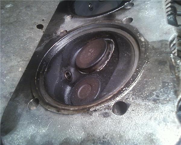

jsayre914   UPDATE... pulled the driverside valve cover to f...   Jan 21 2010, 04:02 PM

Vacca Rabite   pull the pushrod out of the bore and inspect it - ...   Jan 21 2010, 05:50 PM
underthetire   Did you happen to notice if the valve was the same...   Jan 21 2010, 05:51 PM
Vacca Rabite   When you turned the motor over, did it hang up on ...   Jan 21 2010, 05:52 PM
jsayre914   I thought the valve springs all looked similar at ...   Jan 21 2010, 05:58 PM
underthetire   If it was a dropped seat, that Cyl would not have ...   Jan 21 2010, 06:02 PM
jsayre914   If it was a dropped seat, that Cyl would not have...   Jan 21 2010, 06:11 PM
Vacca Rabite   Okay, silly question, but did you have your finger...   Jan 21 2010, 06:28 PM
Vacca Rabite   Have you sent your 2L heads to have them rehabbed ...   Jan 21 2010, 06:31 PM
r_towle   Take a picture of the valves on the drivers side a...   Jan 21 2010, 07:11 PM
jsayre914   The intake valve spring on number one is not as ta...   Jan 22 2010, 12:56 PM
underthetire   The intake valve spring on number one is not as t...   Jan 22 2010, 01:05 PM
Vacca Rabite   :agree: What he said. Thats going to be another ...   Jan 22 2010, 02:08 PM

Vacca Rabite   You have got crap compression on the cylinder at 6...   Jan 22 2010, 10:58 PM
jsayre914   You have got crap compression on the cylinder at ...   Jan 24 2010, 10:16 AM

kwales   I'd bet it is a dropped seat. The seat came o...   Jan 26 2010, 02:50 PM

Dave_Darling   Been there, done that, got the new underwear after...   Mar 25 2010, 12:27 AM
Vacca Rabite   Did the piston survive? Zach   Mar 25 2010, 05:50 AM
jsayre914   Did the piston survive? Zach i will take some p...   Mar 25 2010, 05:48 PM
kwales   I'd recommend doing both heads at the same tim...   Mar 25 2010, 09:01 PM
jsayre914   <_<   Mar 26 2010, 09:51 AM
Vacca Rabite   Retire that engine, Joe. Its done. Its just not ...   Mar 26 2010, 03:31 PM
jsayre914   Retire that engine, Joe. Its done. Its just not...   Mar 26 2010, 03:42 PM
Brando   I agree. Start getting the parts from Jake Raby...   Mar 28 2010, 08:16 AM
Dave_Darling   Get all of the intake seats done. The other three...   Mar 27 2010, 03:29 AM
