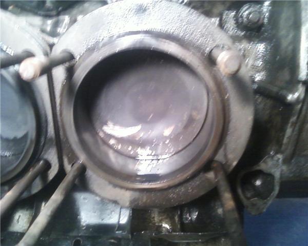

jsayre914   UPDATE... pulled the driverside valve cover to f...   Jan 21 2010, 04:02 PM

kwales   I'd bet it is a dropped seat. The seat came o...   Jan 26 2010, 02:50 PM
jsayre914   you guessed it   Mar 24 2010, 09:50 PM

Dave_Darling   Been there, done that, got the new underwear after...   Mar 25 2010, 12:27 AM
Vacca Rabite   Did the piston survive? Zach   Mar 25 2010, 05:50 AM
jsayre914   Did the piston survive? Zach i will take some p...   Mar 25 2010, 05:48 PM
