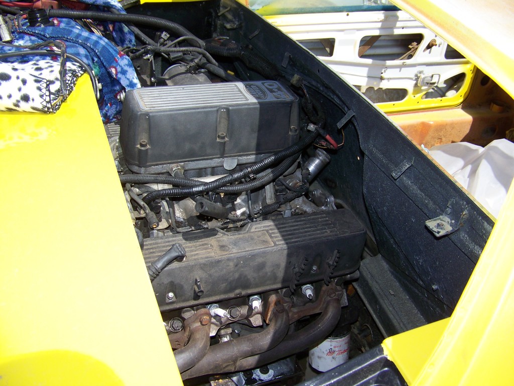

Got the engine in to check all the clearances. Fabricated a couple of motor mounts that I welded to the stock early 914 crossbar.

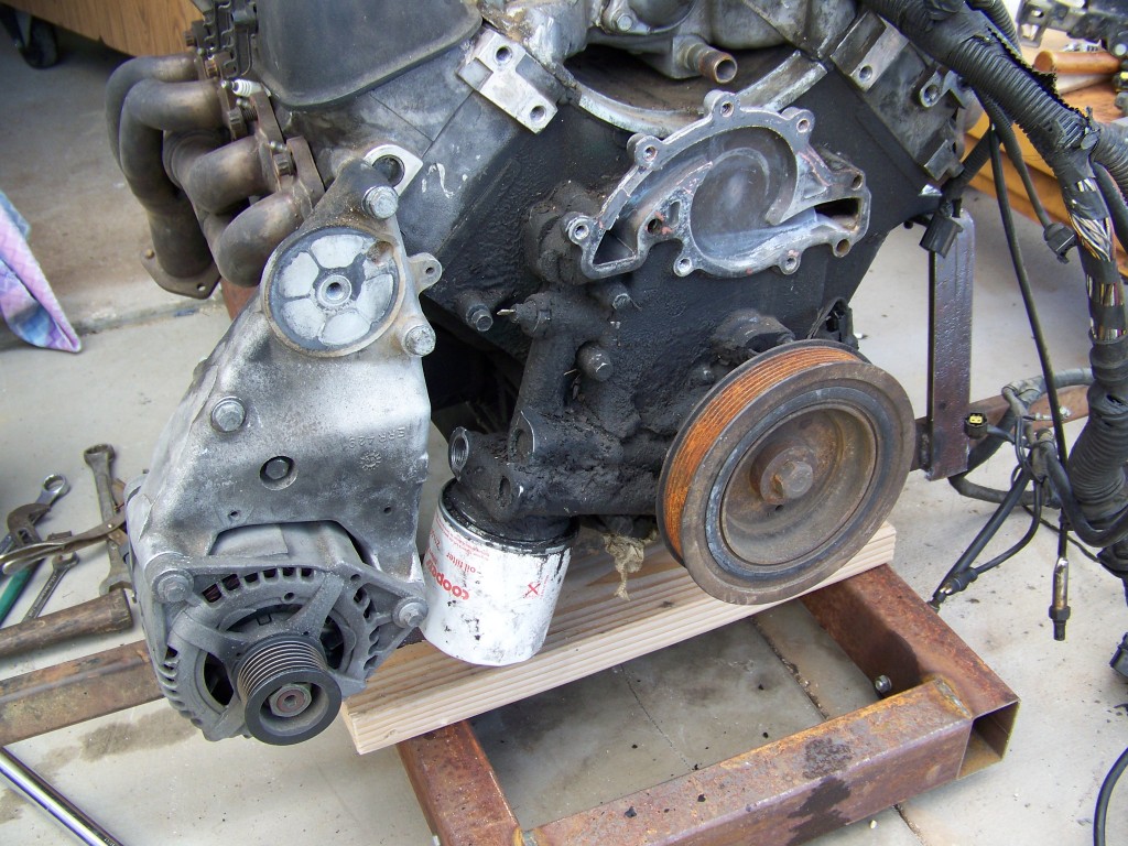

Was brainstorming how to mount alternator down low (where space is available). Figured out that I could simply flip stock alternator bracket 180 degrees and the mounting holes (2 at least) would line up. When everything is tight it is very solid.

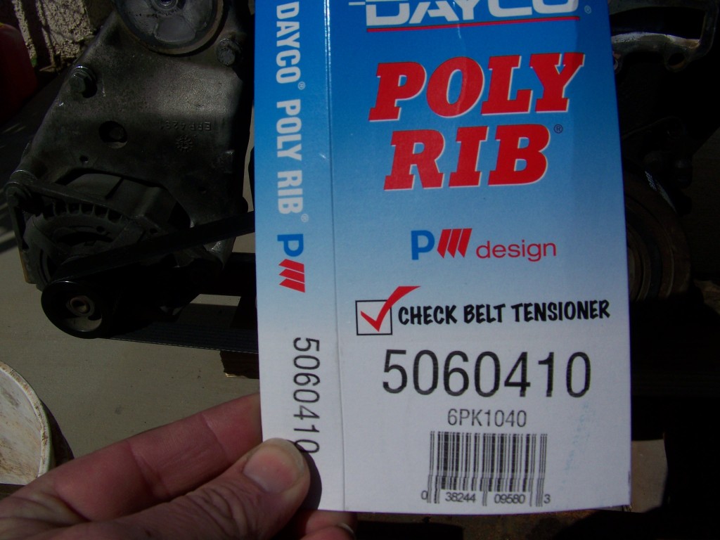

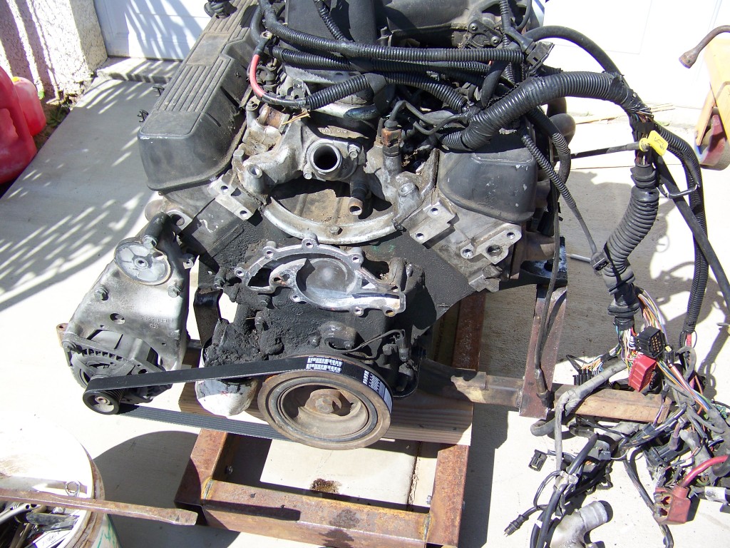

Location is perfect, though I may need to cut a bit of the tin near the firewall. Had to make several trips to Parts Store to determine the perfect belt (41").
