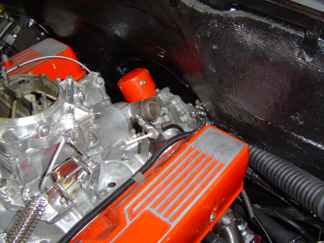

For you Rover V8 guys, here's where you're going to hit the firewall.

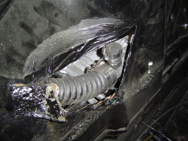

The cut in the firewall from inside the cabin:
This is with the transaxle back about 1" from stock. You could probably move it back another 3/4" and avoid a cut altogether, but I just wasn't comfortable with that much angle on the CV joints. With some judicious carving on the backpad and passenger seat and a bit of sheetmetal I don't think it'll be noticeable.
