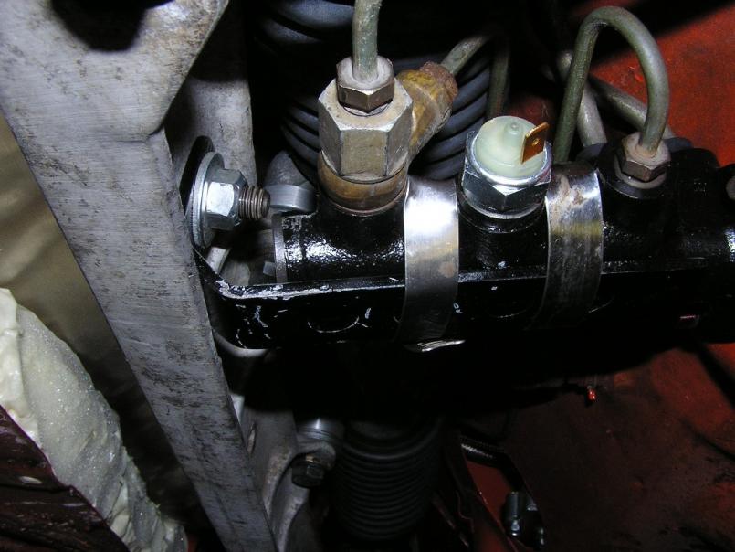

Took this video to post in my "Hold the phone!" build thread, but for those who might miss it, this is a repost.
brant
post Apr 7 2010, 07:15 PM
Posts: 12,282
From: Colorado
Member No.: 47
fixing the flex is a good thing
it will help firm up the "feel"
we did this on our old car about 15 years ago
and on the new one when we built it 6 years ago also
here is the new ones method with lightening holes:

McMark   Rick, the factory bracing/box which is under the p...   Apr 7 2010, 12:25 PM
McMark   Well, here's what it took to get it immobile. ...   Apr 7 2010, 03:01 PM
rick 918-S   Ya, I know the brace is open. I was looking at the...   Apr 7 2010, 03:09 PM
McMark   There is one of those U-slits under the pedal clus...   Apr 7 2010, 03:11 PM

Root_Werks   That's a good fix! When mine's up in ...   Apr 7 2010, 03:16 PM
veltror   My floor is rotten so Marek is making up a triple...   Apr 7 2010, 04:15 PM

Racer Chris   http://www.914world.com/bbs2/uploads_offsite/www.t...   Apr 7 2010, 07:35 PM
McMark   Chris, how do you change the MC?   Apr 7 2010, 08:29 PM
Racer Chris   http://www.914world.com/bbs2/uploads_offsite/www.t...   Apr 7 2010, 08:50 PM
Racer Chris   Actually, the pictures are of a prototype. We adde...   Apr 7 2010, 08:51 PM
PRS914-6   Here is my installation with a hydraulic clutch. ...   Apr 7 2010, 09:02 PM
McMark   AHA! Chris, you were hiding the details from ...   Apr 7 2010, 09:15 PM
