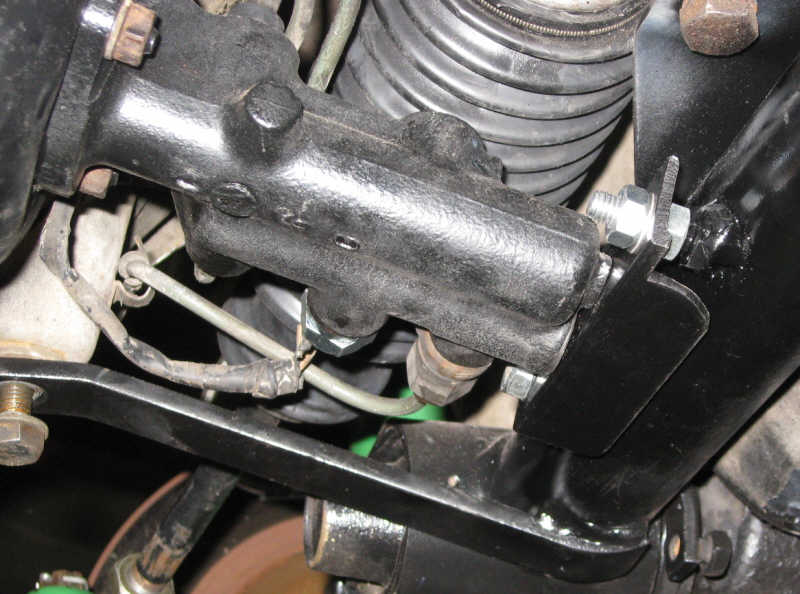

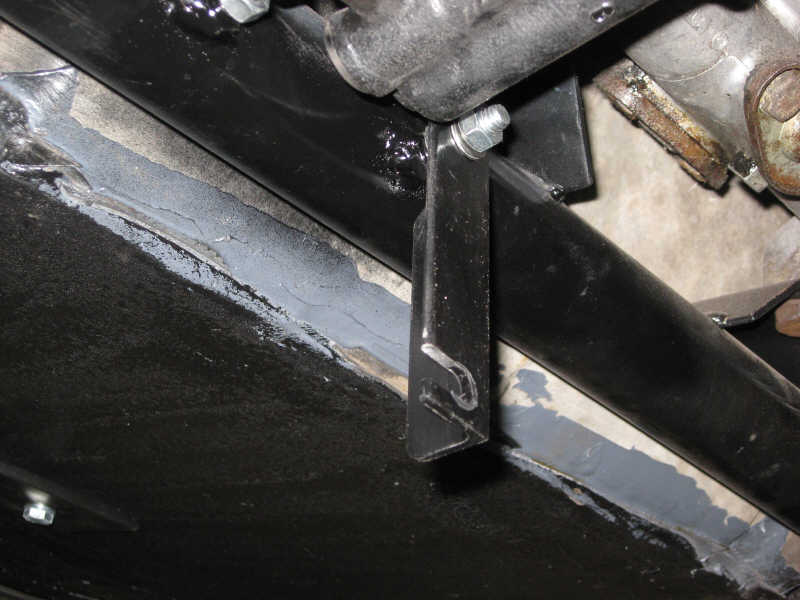

ChrisFoley
post Apr 7 2010, 07:35 PM
I am Tangerine Racing
Posts: 8,033
Joined: 29-January 03
From: Bolton, CT
Member No.: 209
(IMG:http://www.914world.com/bbs2/uploads_offsite/www.tangerineracing.com-209-1270690536.1.jpg)

McMark   Chris, how do you change the MC?   Apr 7 2010, 08:29 PM
Racer Chris   http://www.914world.com/bbs2/uploads_offsite/www.t...   Apr 7 2010, 08:50 PM
Racer Chris   Actually, the pictures are of a prototype. We adde...   Apr 7 2010, 08:51 PM
PRS914-6   Here is my installation with a hydraulic clutch. ...   Apr 7 2010, 09:02 PM
McMark   AHA! Chris, you were hiding the details from ...   Apr 7 2010, 09:15 PM
