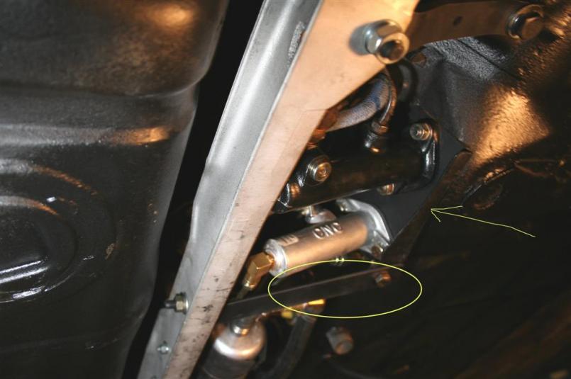

Here is my installation with a hydraulic clutch. It is quite simple to add some reinforcing with some scrap metal. It is attached to the suspension beam. Note the plate under both cylinders that is flanged.

PRS914-6   Here is my installation with a hydraulic clutch. ...   Apr 7 2010, 09:02 PM
