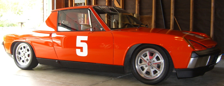

So my latest build is a '75 Appearance Group car.
Car is currently in the body shop being stripped to bare metal.
Motor and tranny were just rebuilt...
going for a retro look.
Rivs, Porsche negative side stripe, Monza exhaust, Vittaloni mirrors and a few interior items to keep it '70s (IMG:style_emoticons/default/happy11.gif)

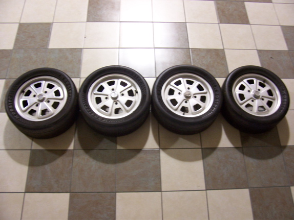

first pic is one of the heater tubes media blasted
second pic is tube final product.
entire exhaust system will be done the same.
Pic of one of the Rivs I did a quick polish with power ball and aluminum polish..
black paint on the Rivs is perfect, just needs to be cleaned and waxed.
here are a couple of pics of stuff that will be media blasted by myself tomorrow and then painted by me (IMG:style_emoticons/default/smile.gif)

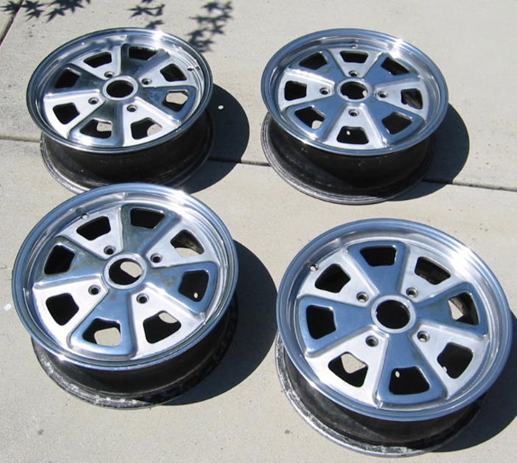

Looky what I found the other day.... (IMG:style_emoticons/default/shades.gif)
with a little bit of various grits of sand paper and then some aluminum polishing compound, these should shine up pretty good like my last set....(bottom pic)
Tom_T
post Apr 9 2010, 10:08 AM
TMI....
Posts: 8,321
Joined: 19-March 09
From: Orange, CA
Member No.: 10,181
QUOTE(DanT @ Apr 9 2010, 08:08 AM) *
Dan - those look sooooo nice! - now don't ruin those Fuchs 2L's by polishing them up all over or otherwise (IMG:style_emoticons/default/sheeplove.gif) the OE finish on them!!! (IMG:style_emoticons/default/dry.gif)
Be careful not to take off that excellent lower sheen background & the anodizing all over on those. I wouldn't use the sand paper - just polish, since they appear to still retain their OE finish - which remember is more of a semi-polished finish due to the anodizing.
See the pix of original wheels on Steve G's Sahara Beige 73 2L at the O&H "The few, the rare..." nailed thread for the OE finish in all its glory! (IMG:style_emoticons/default/drooley.gif)
If you really want to fully sand & polish up a set of Fuchs 2L wheels, I'll trade you a set I have for those to have your fun with - & I'll keep those as they are in OE finish! Heck, I'll be coming thru your way the week of 4/26 for a conference in SF & will drive them up for the swap buddy!!!! (IMG:style_emoticons/default/biggrin.gif)
