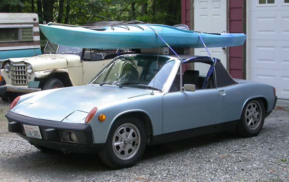

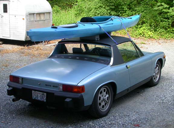

Nice work. I like that you can still take the top off. Here's my crude but effective method.

QUOTE(KELTY360 @ Mar 31 2010, 09:46 AM) *
I'd be afraid of the two strap method... myself..
Kayak the Snoqualmie or Skykomish?

QUOTE(RobW @ Mar 31 2010, 10:55 AM) *
Neither - it's not a whitewater boat. I just use the 2 straps for the 2 mile drive to a put-in on Lk Washington. For longer trips it gets tied down front and back. I am planning on customizing a spare top for a more solid arrangement.
