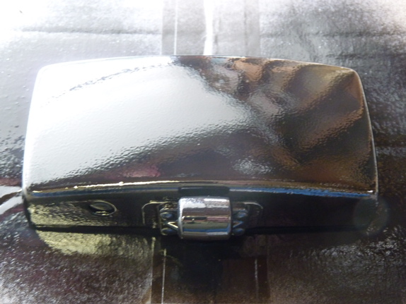

first pic is one of the heater tubes media blasted
second pic is tube final product.
entire exhaust system will be done the same.
Pic of one of the Rivs I did a quick polish with power ball and aluminum polish..
black paint on the Rivs is perfect, just needs to be cleaned and waxed.

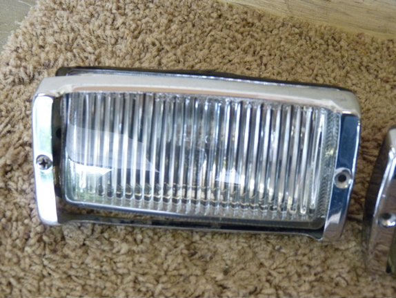

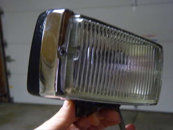

a little more work...
got the fog lights taken apart, cleaned. Sanded and painted the housings, cleaned the chrome retaining ring...reassembled...
