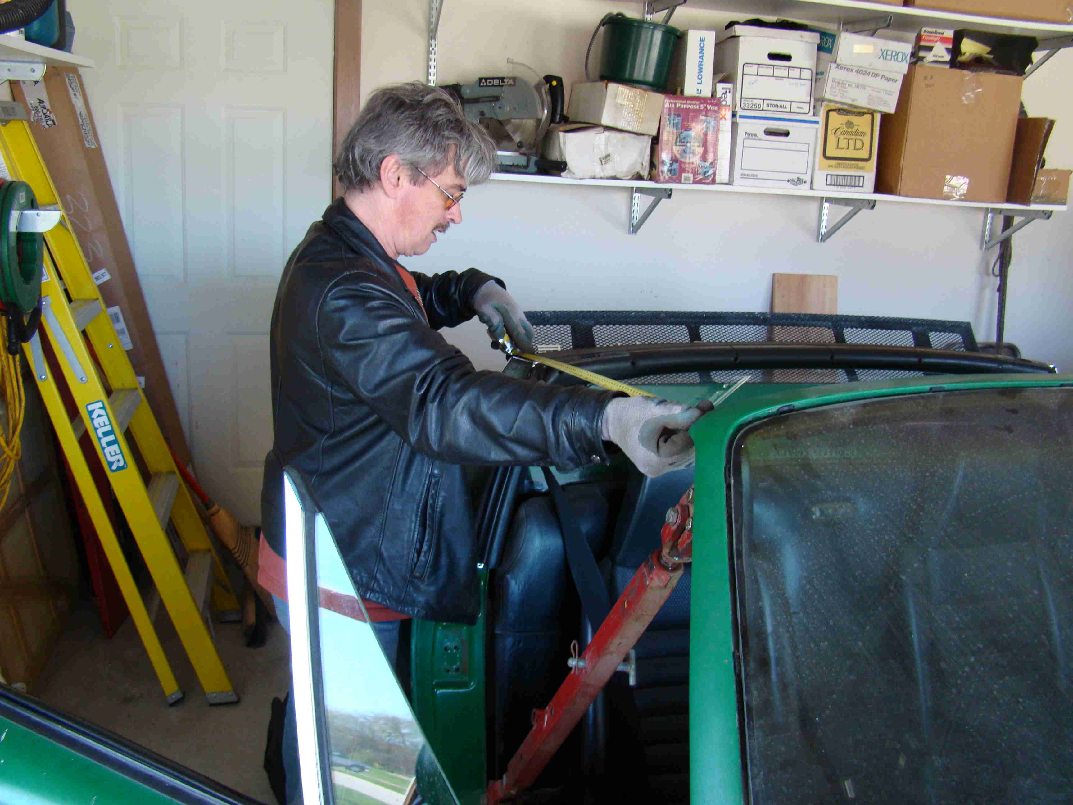

rick 918-S   I thought I had a better photo of this tool but yo...   Aug 26 2009, 10:24 AM
jmill   How does the drivers door fit? If that fits and w...   Aug 26 2009, 11:30 AM
rick 918-S   How does the drivers door fit? If that fits and ...   Aug 26 2009, 05:13 PM

jmill   Do this. Go out to the garage. Remove the targa ...   Aug 26 2009, 06:34 PM
rick 918-S   Do this. Go out to the garage. Remove the targa...   Aug 26 2009, 07:28 PM
jmill   Yup, same measurement.   Aug 26 2009, 07:59 PM
rick 918-S   Yup, same measurement. Ok that confirms the co...   Aug 26 2009, 09:32 PM

jmill   Here's another of picture of "measure 6 t...   Apr 18 2010, 07:50 PM
jmill   When Rick was through the door closed like butter....   Apr 18 2010, 07:57 PM
