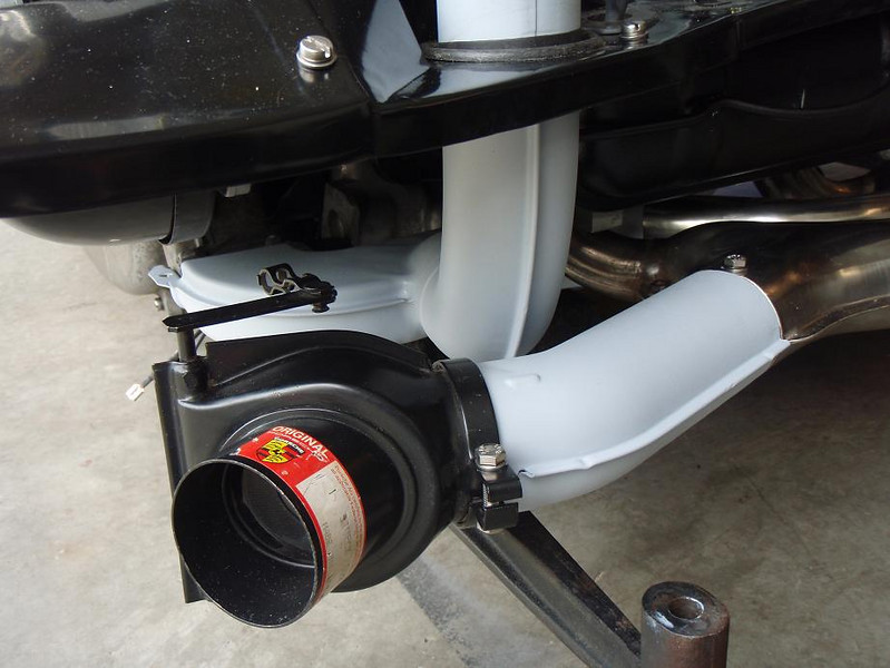

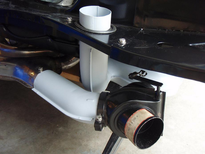

Here's a couple shots of the exhaust pieces installed. Notice the Porsche flapper boxes with the stickers still on. I bought these a few years ago from a member here and am finally getting to installed them.
Left side:

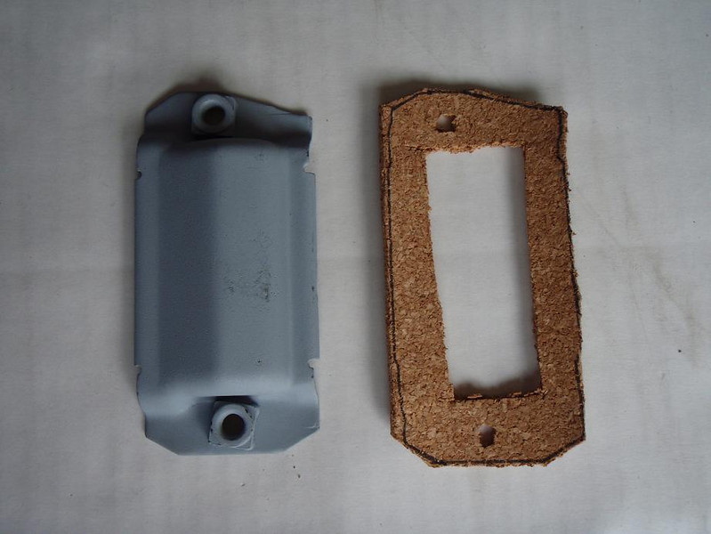

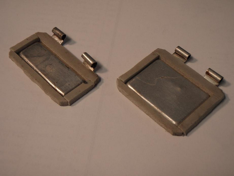

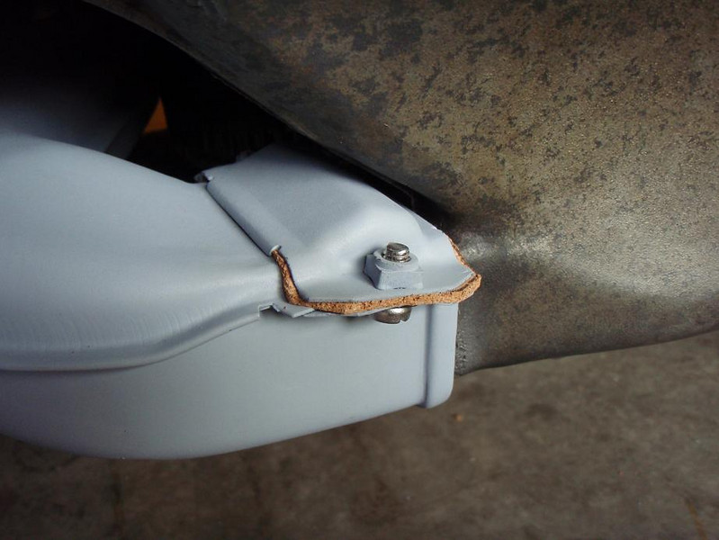

A couple details in this process that I'll point out are the small flaps between the engine shroud and the Y pipes. These originally came with adhesive foam, which mostly disintegrated on my pieces, so I stuck some thin weather stripping to them. Thicker than I would like, but it did the trick and was available at Ace. (IMG:style_emoticons/default/biggrin.gif)
(IMG:http://www.914world.com/bbs2/uploads_offsite/rosalindapetrisko.smugmug.com-4469-1271651283.3.jpg)
Over these flaps sit the small cover pieces. These pieces originally came with gaskets, which are long gone. I cut a primitive gasket from cork.
(IMG:http://www.914world.com/bbs2/uploads_offsite/rosalindapetrisko.smugmug.com-4469-1271651283.4.jpg)
It installed easily, and looks like it will seal nicely.

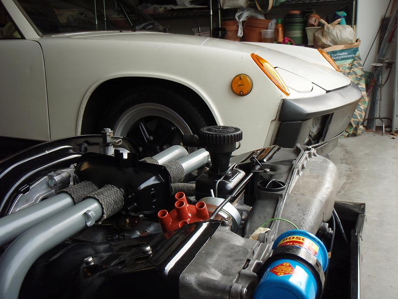

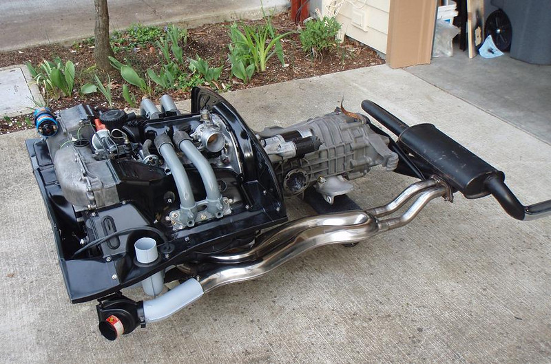

Almost time put the engine back in and free up some garage floor space. I have an old original muffler that I plan on stripping and repainting in gray high temp paint to replace the Sebring.
(IMG:http://www.914world.com/bbs2/uploads_offsite/rosalindapetrisko.smugmug.com-4469-1271651284.6.jpg)
A couple more shots before it goes back in. I especially like how my wife's gardening stuff accentuates the 914. (IMG:style_emoticons/default/biggrin.gif)
(IMG:http://www.914world.com/bbs2/uploads_offsite/rosalindapetrisko.smugmug.com-4469-1271651284.7.jpg)
