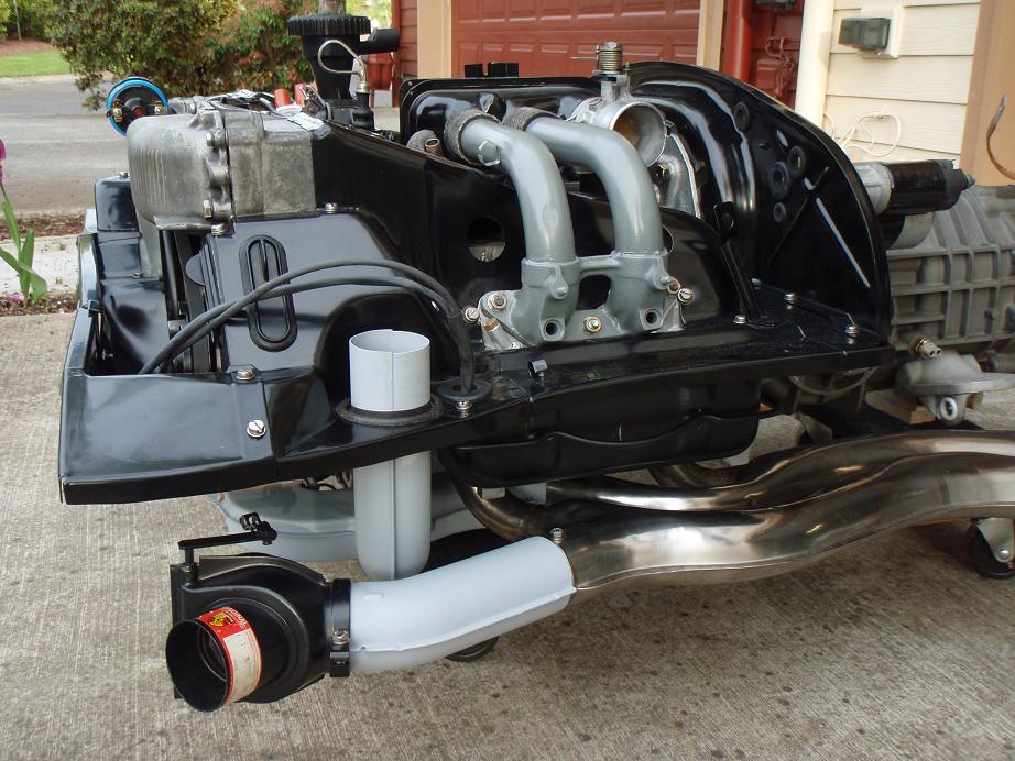

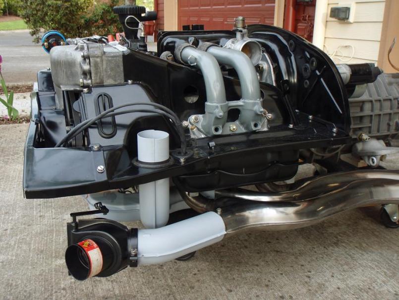

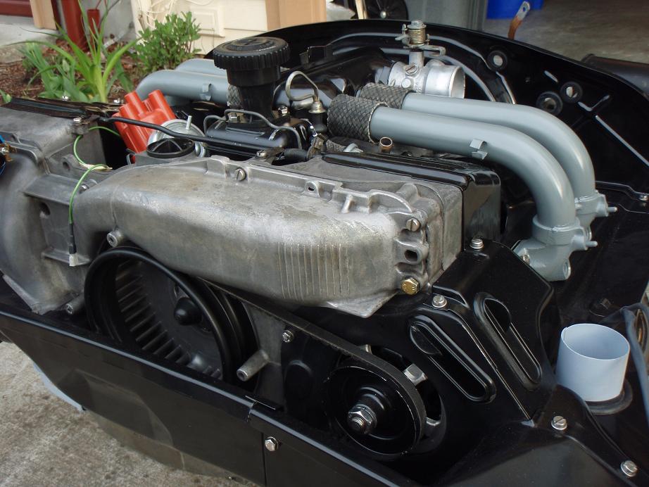

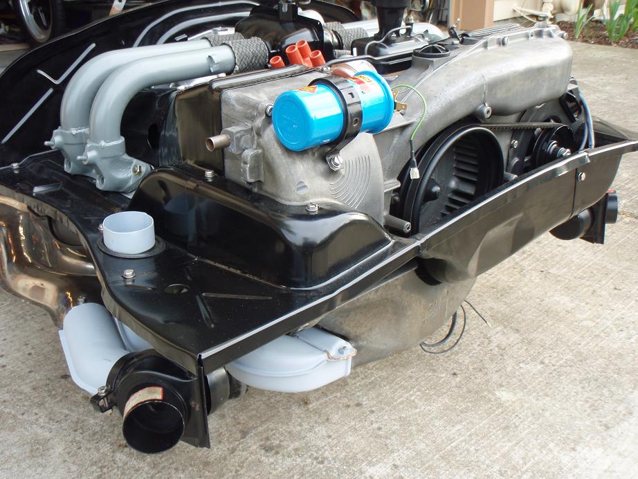

MrKona   An update of the latest status of my engine rebuil...   Apr 18 2010, 10:28 PM
MrKona   A couple more shots of the engine before it goes i...   Apr 18 2010, 10:30 PM
