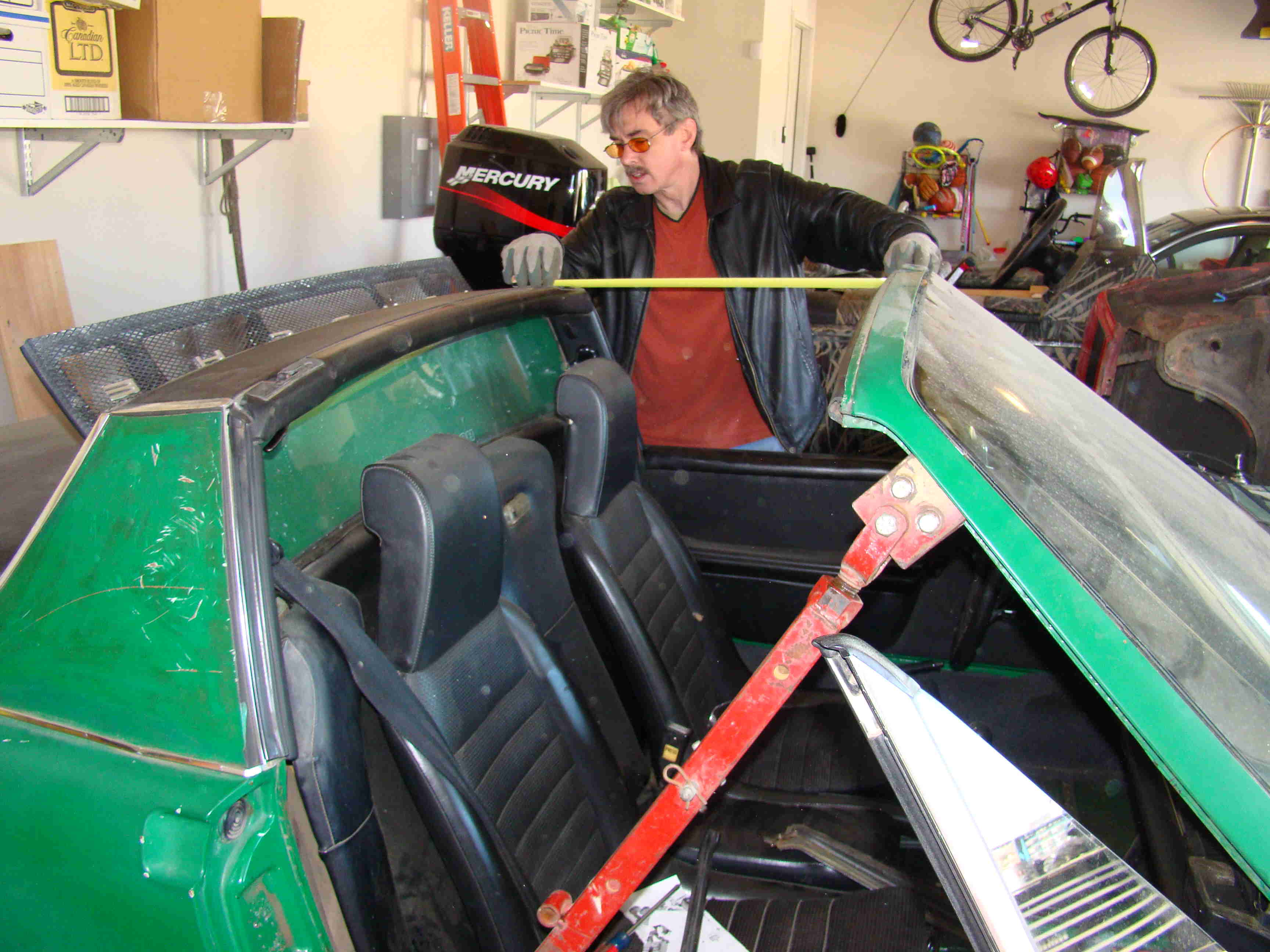

There was an Alien sighting in Racine Wisconsin this weekend. Here we see a picture of the Creator in his natural environment.

QUOTE(jmill @ Apr 18 2010, 08:48 PM) *
Just had to show off my cool spreader. (IMG:style_emoticons/default/assimilate.gif)

jmill   Here's another of picture of "measure 6 t...   Apr 18 2010, 07:50 PM
jmill   When Rick was through the door closed like butter....   Apr 18 2010, 07:57 PM
