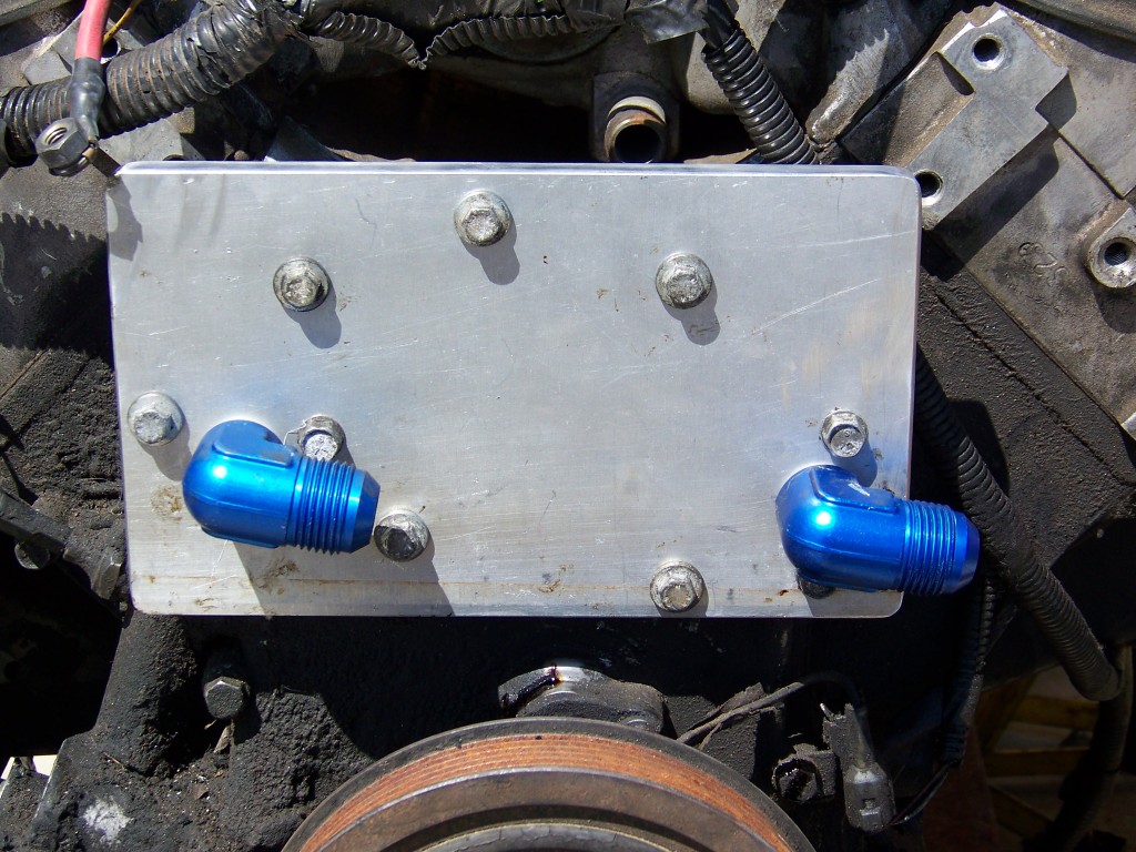

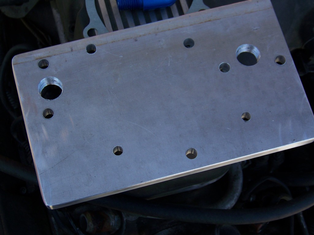

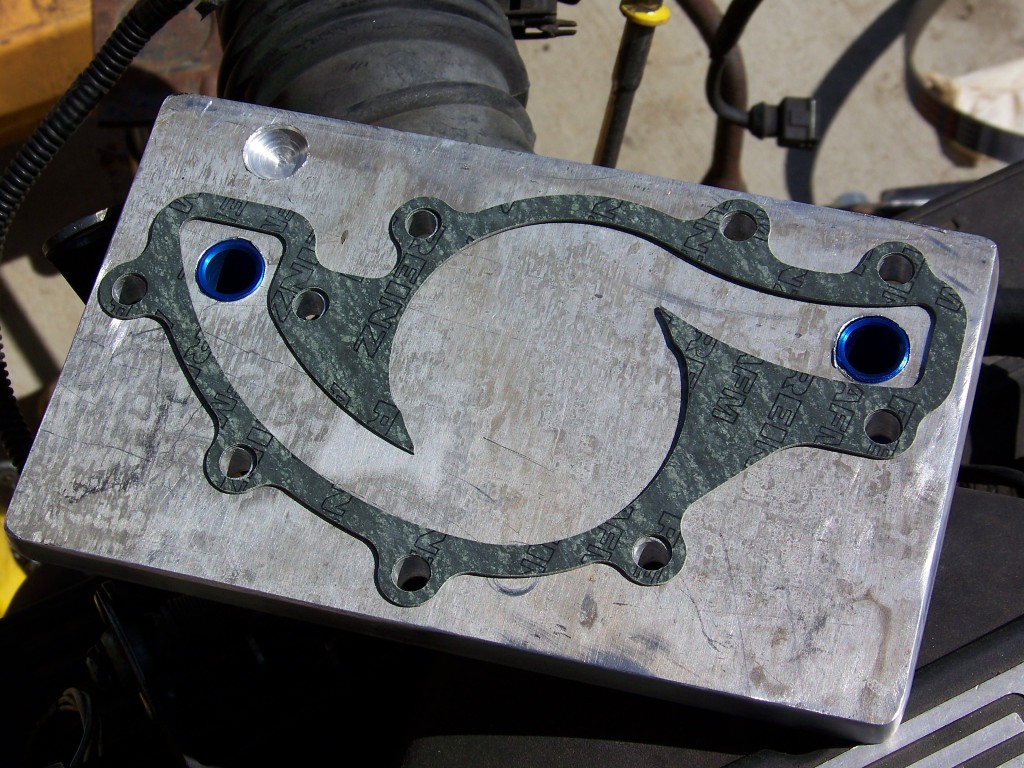

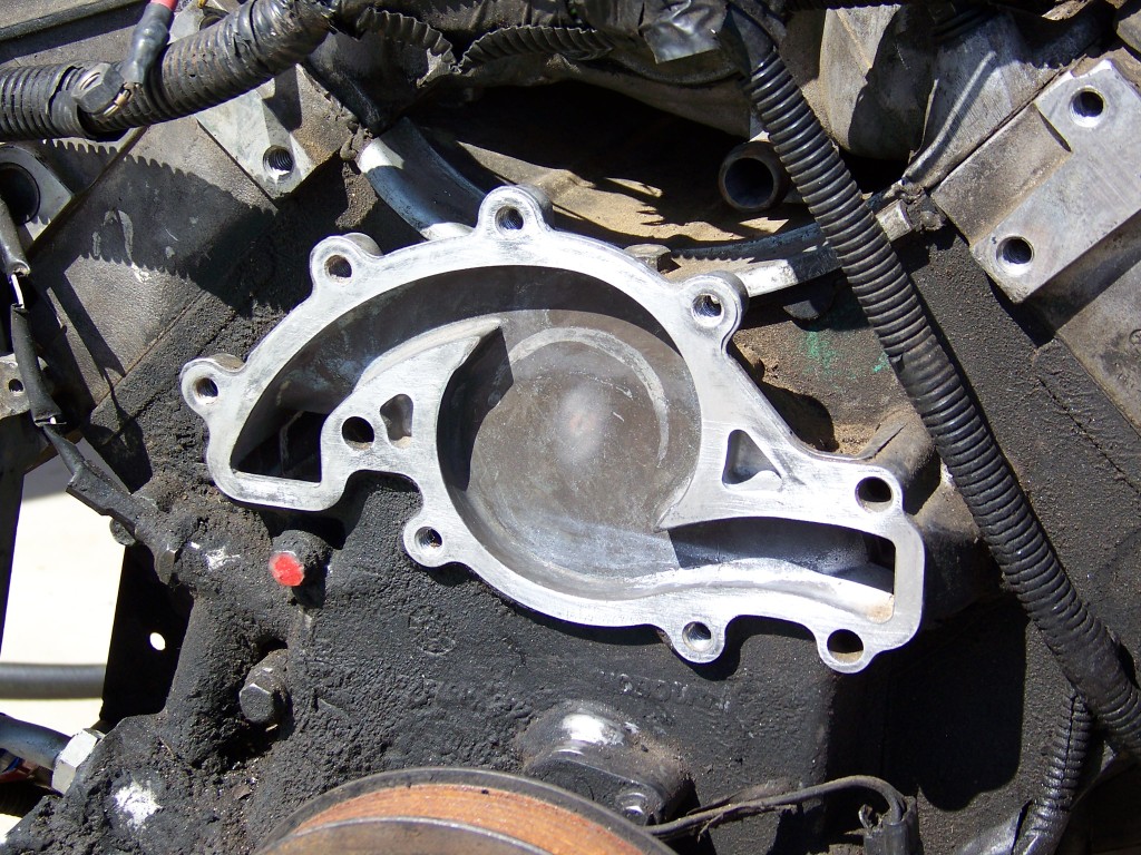

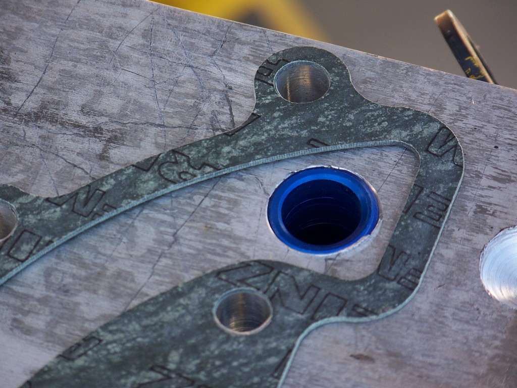

Hi Tom,
You asked for a few pics of the water-pump block-off plate a made. Here you go...!
