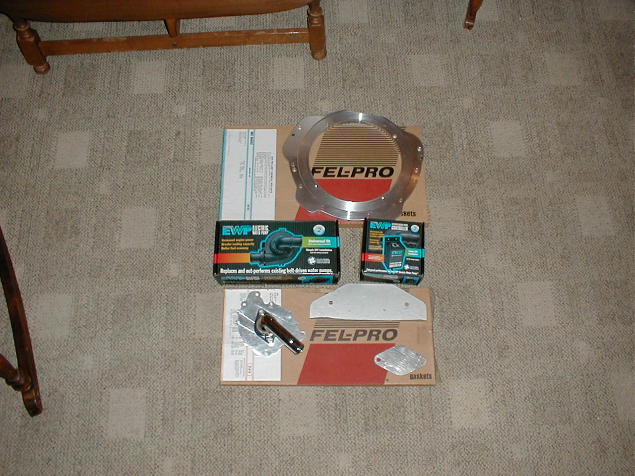

Good to see some progress being made. My picture of the plate I had made. It is in the lower left part of the photo.
Be good to see if we can make this engine shorter.
