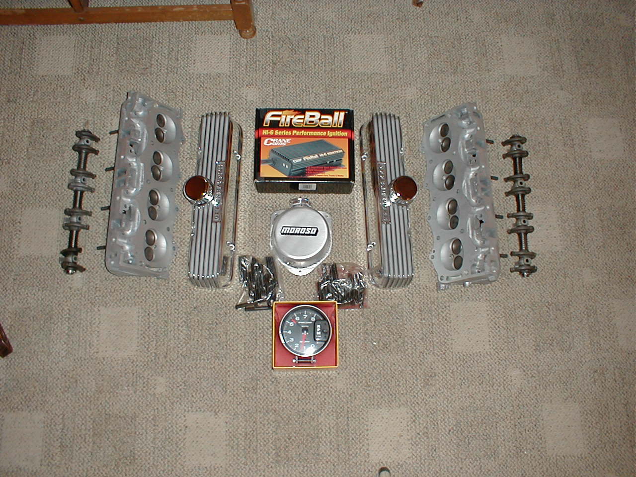

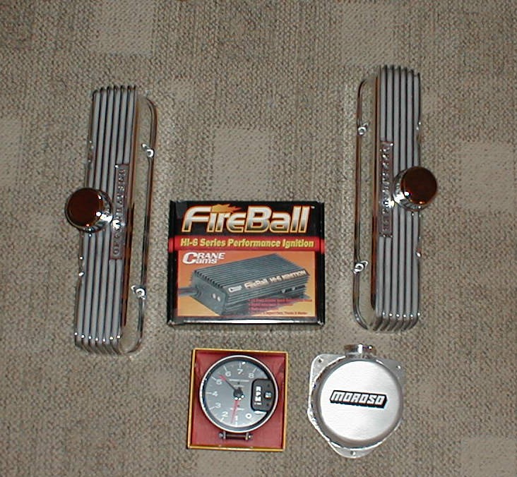

Let me add a few more photos--perhaps it will motivate me to get going.

codices   Good to see some progress being made. My picture ...   Apr 28 2010, 01:39 PM
codices   Let me add a few more photos--perhaps it will moti...   Apr 28 2010, 01:50 PM
codices   Just a few more.   Apr 28 2010, 01:53 PM
codices   Maybe a couple more. This last one shows the en...   Apr 28 2010, 02:02 PM
