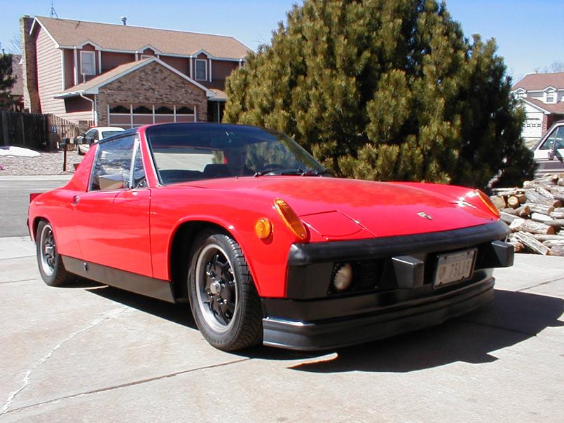

Help me, I can't stop. Last two. The first one is the restored '74 2.0 that now lives with my daughter. The second one in the garage is the present victim also a '74 originally a 1.8 Zambezi Green going back to that color upon completion.
Dave
