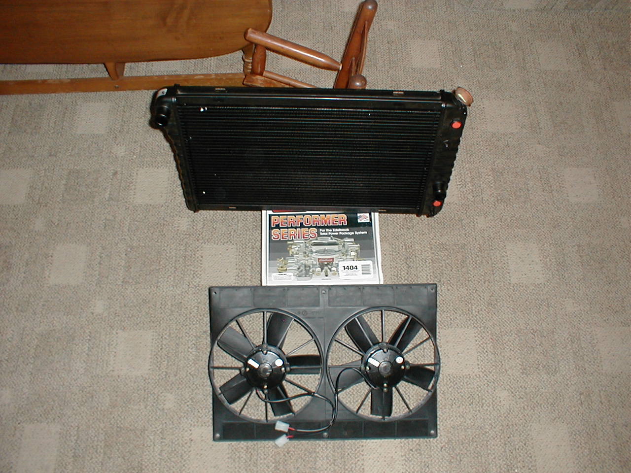

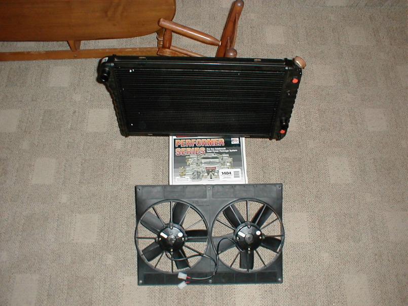

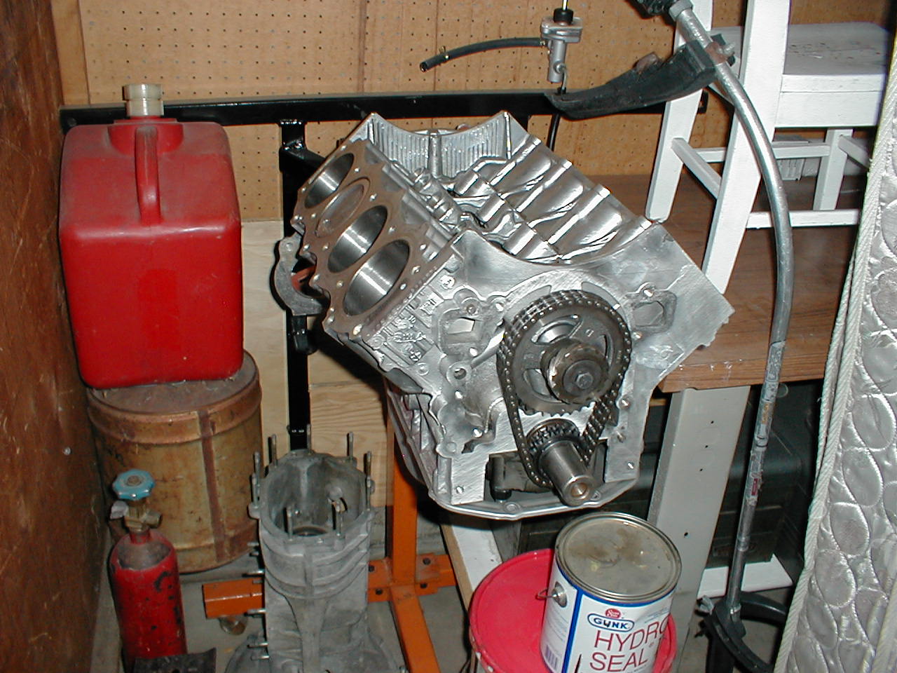

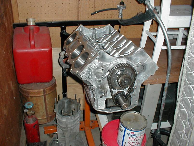

Maybe a couple more.
This last one shows the engine block with the cradle in the background.
Engine has ARP studs throughout with Crane cam, high pump-up lifters, double valve springs. Had to add "heavy metal" to the crank during the balancing. Perhaps this summer after my welding stint.
Dave

Wow Dave - Great Stuff! GET GOING! Hey, tell me about that radiator/shroud/fan assembly.
Bob
