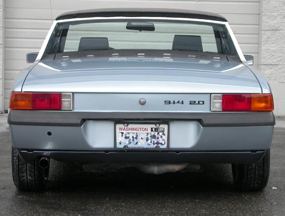

About a month ago I flattened my right fender while attempting to submerge under the bumper of a Chevy Tahoe. As embarrassing as that was, it forced me to take the car off the road for repairs. Given the splotchy, oxidized finish it was silly to try to match the paint, so the only logical path was to finally do the full cosmetic makeover I'd always intended.
After getting recommendations from the incredibly sympathetic members of the PNW contingent. I contacted Eurotech Bodywerkes to do the work. The owner is a 914 owner as is one of the metal massagers, Slow914. They mostly specialize in German stuff with some other interesting rigs sprinkled in for interest.
Here's the initial damage that triggered everything.
The original plan was to strip down as far as necessary to insure good adhesion, but after discovering numerous problems from previous repairs, it was taken down to bare metal.
Sail vinyl was removed and the trim holes filled.
I was offered a hood and fender by 914Junkie down in Vancouver, WA - thanks Paul. We were able to use the fender in the repair but the hood was a little too rusty. I also discovered that the hood off my parts car was too rusty, but finally I found one from rdauenhauer that worked - thanks Rich (and effutou101 - Chris for delivery).
The fender repair looks great.

When I picked up the car I got one pic and the camera battery died. Here's a tease.
More pics manana.

KELTY360   It's home! It's beautimous! And ...   Apr 30 2010, 08:15 PM

KELTY360   When I picked up the car I got one pic and the cam...   Apr 30 2010, 10:37 PM
