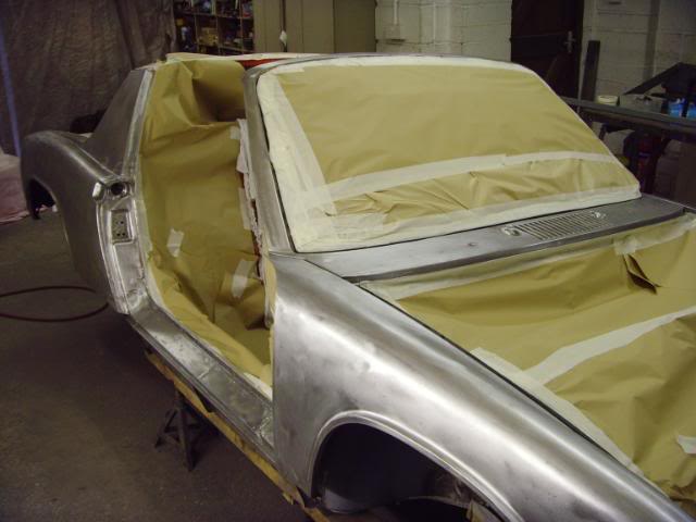

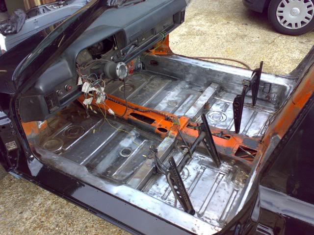

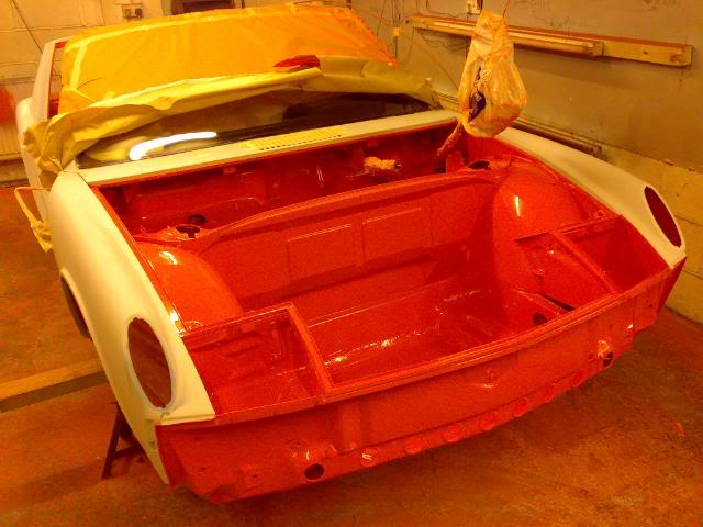

Stripped by hand, all over, under and inside. Totally worth it (almost finished +2yrs working very part time) (IMG:style_emoticons/default/chair.gif)
Only parts left in were: screen, dash and wiring loom.
(IMG:http://www.914world.com/bbs2/uploads_offsite/i285.photobucket.com-8136-1272792541.1.jpg)
(IMG:http://www.914world.com/bbs2/uploads_offsite/i285.photobucket.com-8136-1272792541.2.jpg)
(IMG:http://www.914world.com/bbs2/uploads_offsite/i285.photobucket.com-8136-1272792542.3.jpg)
