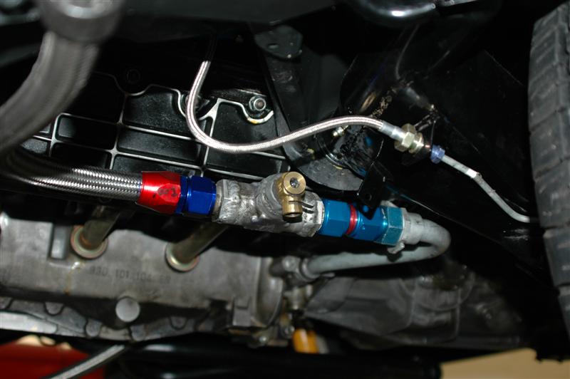

This is what I've done. Although not using the stock lines it's easy to drain the tank. I just loosen the an lines a little and rotate the ball valve to the down position and drain......
