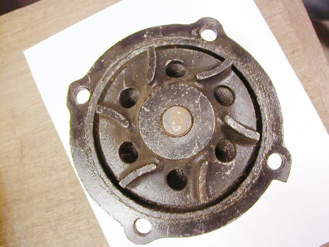

My Renegade water pump failed yesterday. The pump impeller is stamped steel and the blades all just folded over or sheared off. I understand that the cast impellers are much stronger, but that not all manufacturer's cast models will fit into the Renegade housing. Anybody have experience with cast impeller pumps that will fit into the Renegade housing?
Since there is no bypass in the Renegade system, Renegade instructions are to limit the motor RPM to 3,000, or less, untill the thermostat opens. I have observed this, but the pump still failed after 5,500 miles. Renegade now makes a bypass kit, which I going to try, but I would still like to get a more durable pump.
Nick

Actually, this is the third SBC conversion that has had impeller failure in the last year: 1 Tony in WA, 2 drivability and 3 nick in SF.
Here's the best thread on the pumps that I've seen.(IMG:http://www.914world.com/bbs2/uploads_offsite/i239.photobucket.com-4253-1273205192.1.jpg)

TC 914-8   Yep I was one of those recient failures. I went ...   May 6 2010, 11:44 PM
messix   Yep I was one of those recient failures. I went...   May 7 2010, 08:43 AM
nick mironov   That failure looks exactly like mine... The threa...   May 6 2010, 11:56 PM
