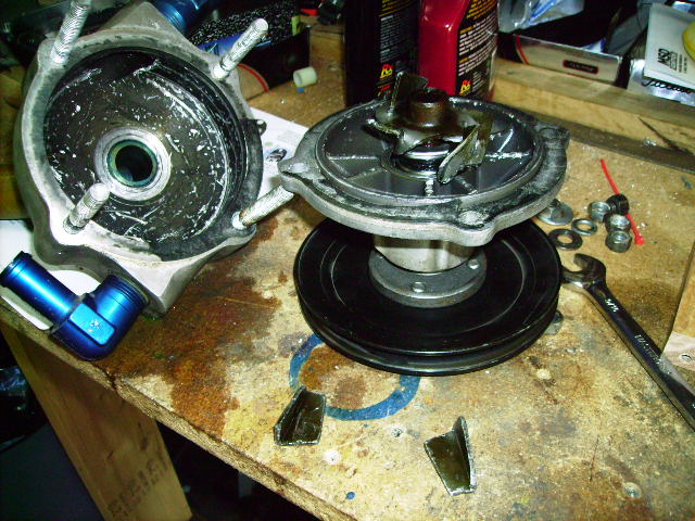

My Renegade water pump failed yesterday. The pump impeller is stamped steel and the blades all just folded over or sheared off. I understand that the cast impellers are much stronger, but that not all manufacturer's cast models will fit into the Renegade housing. Anybody have experience with cast impeller pumps that will fit into the Renegade housing?
Since there is no bypass in the Renegade system, Renegade instructions are to limit the motor RPM to 3,000, or less, untill the thermostat opens. I have observed this, but the pump still failed after 5,500 miles. Renegade now makes a bypass kit, which I going to try, but I would still like to get a more durable pump.

nick mironov   This is the Test Setup. Although the pump housin...   May 26 2010, 10:00 AM
nick mironov   This is the Lineup of the Tested Impellers. [ Th...   May 26 2010, 10:02 AM
nick mironov   Failed Stamped Impeller. The impeller failed duri...   May 26 2010, 10:04 AM
nick mironov   Replacement Stamped Impeller This is an exact rep...   May 26 2010, 10:05 AM
nick mironov   3.66” Diameter Cast Impeller This is the small ...   May 26 2010, 10:06 AM
nick mironov   4.365” Cast Impeller I first thought that the i...   May 26 2010, 10:07 AM
nick mironov   The Housing   May 26 2010, 10:08 AM
nick mironov   Replacement Stamped Impeller in Housing Note that...   May 26 2010, 10:09 AM
nick mironov   4.365” Cast Impeller in Housing There is also g...   May 26 2010, 10:10 AM
nick mironov   4.365” Cast Impeller in Housing Note that there...   May 26 2010, 10:11 AM
nick mironov   3.66” Cast Impeller in Housing Note the very sm...   May 26 2010, 10:12 AM
nick mironov   Housing After I finished testing everything, I cl...   May 26 2010, 10:13 AM
nick mironov   3.66” Cast Impeller in Housing after Beveling th...   May 26 2010, 10:14 AM
nick mironov   [b]The Results Since I did not have test equipmen...   May 26 2010, 10:16 AM
