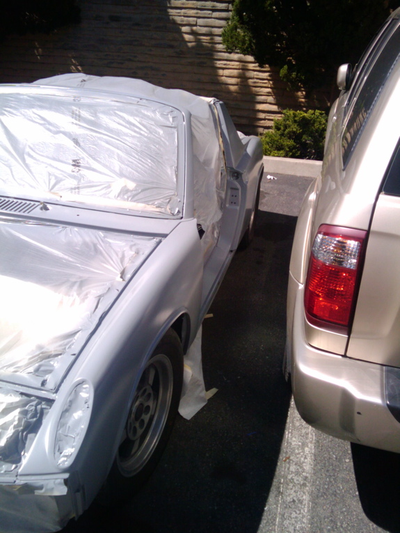

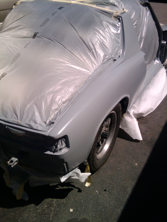

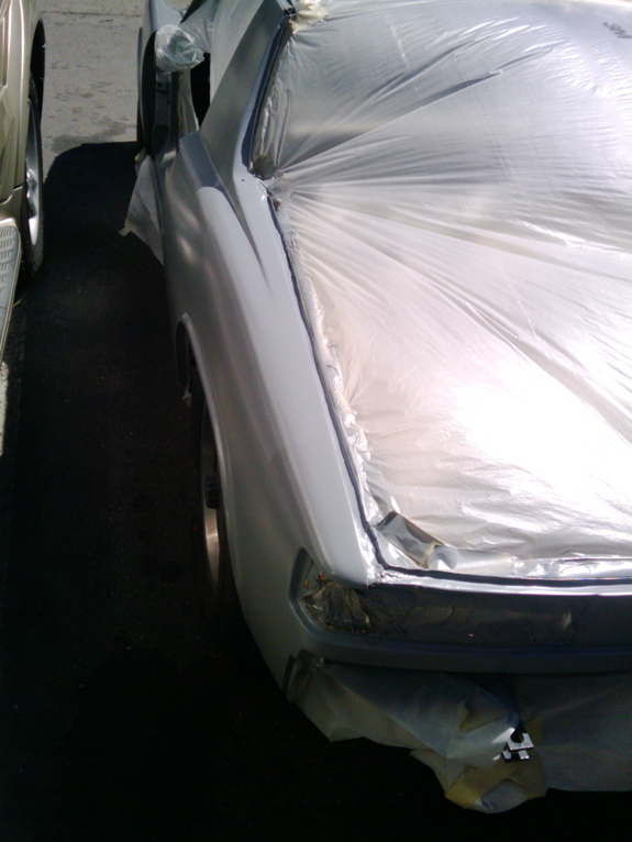

DanT   painter was supposed to make some more progress ov...   May 31 2010, 10:46 PM
DanT   Just returned from the body shop. Car is completel...   Jun 4 2010, 11:05 AM
