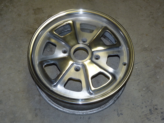

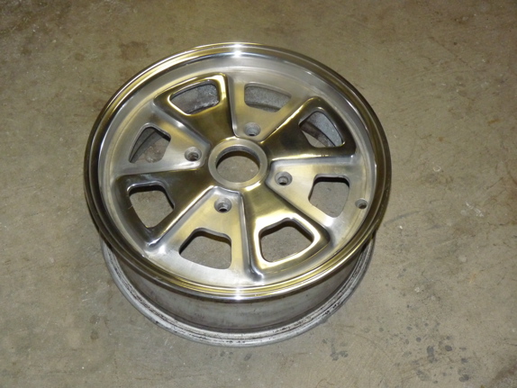

Had some time this evening so I decided to do a bit of polishing.
I had already stripped two of the wheels with oven cleaner so decided it was time to give it a whirl...
a bit of 1000 and 1500 grit, a little aluminum wheel polish and a buffing wheel on my cordless drill and this is what I came up with.
I left the recessed areas in a brushed finish and only polished the raised petals and the rim....
Came out pretty nice for about an hour and a half of time...
better than what they started looking.

DanT   Had some time this evening so I decided to do a bi...   May 14 2010, 10:13 PM
Tom_T   Had some time this evening so I decided to do a b...   May 14 2010, 11:12 PM
KELTY360   Very nice. How will you preserve the finish?   May 14 2010, 10:16 PM
DanT   I will put on a nice coat of wax and after I get t...   May 14 2010, 10:20 PM
KELTY360   You make some pristine racers Dan.   May 14 2010, 10:22 PM
DanT   Thanks I enjoy building them. I just should have h...   May 14 2010, 10:27 PM
DanT   yes the oven cleaner removes the anodizing... leav...   May 14 2010, 11:44 PM
