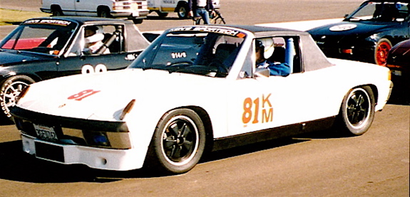

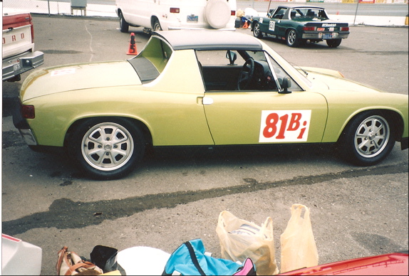

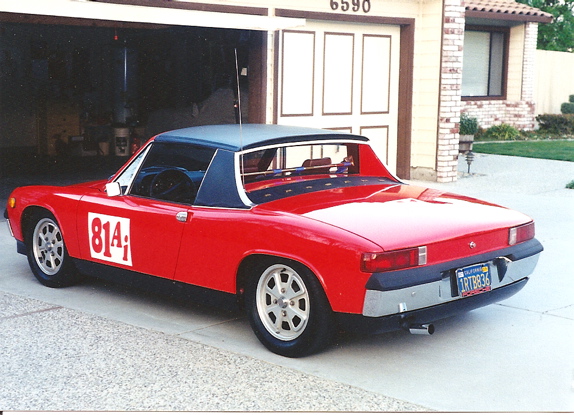

I just should have hung on to a couple of them... (IMG:style_emoticons/default/biggrin.gif)
'70 1.7L in Tangerine
'73 2.0L in Delphi Green Metallic
'70 2.7L RS in Ivory
