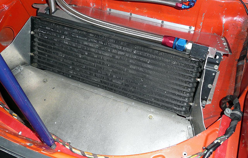

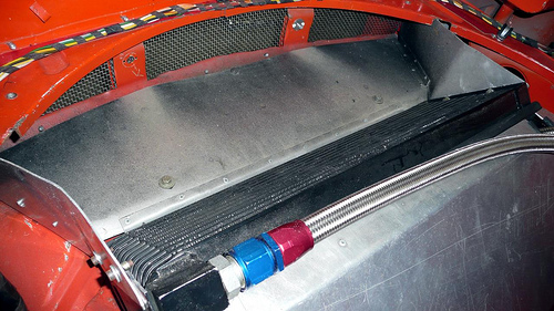

But we digress. I went ginormous and invasive with my oil cooler since it's a track car that is virtually always >5000rpm, and it gets really hot around here (i.e., Willow Springs). Ottos did the fab work, and it was not cheap, nor is anything like this necessary for a street car. Obviously the top shroud/cover is removed in the pic.
(IMG:http://www.914world.com/bbs2/uploads_offsite/farm4.static.flickr.com-21-1273946042.1.jpg)
(IMG:http://www.914world.com/bbs2/uploads_offsite/farm4.static.flickr.com-21-1273946337.1.jpg)
I'm going big on my cooler too, since it's mostly intended as a track car and while it doesn't get Willow hot (BTDT...) 100ºF is 100ºF and if I'm making 2,8RSR power (~305) it needs RSR cooling...
