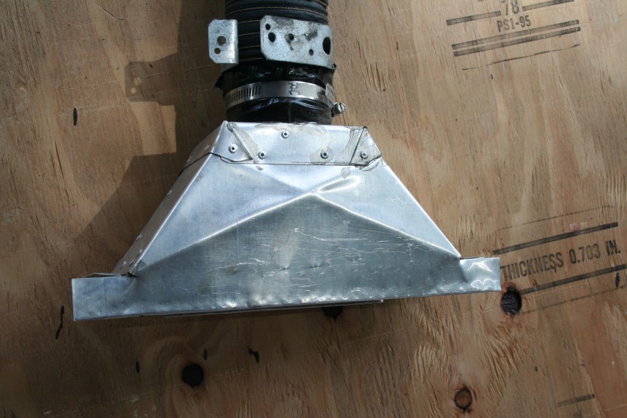

I got rid of the Home Depot scoop (IMG:style_emoticons/default/barf.gif) and made one that fits the cooler a little better. (IMG:style_emoticons/default/biggrin.gif)

Elliot Cannon   Start your car and put your hand down by the vents...   May 18 2010, 12:25 PM
realred914   Start your car and put your hand down by the vent...   May 18 2010, 01:53 PM
Cevan   Start your car and put your hand down by the ven...   May 18 2010, 02:27 PM
Elliot Cannon   I got rid of the Home Depot scoop :barf: and made...   May 18 2010, 12:27 PM
