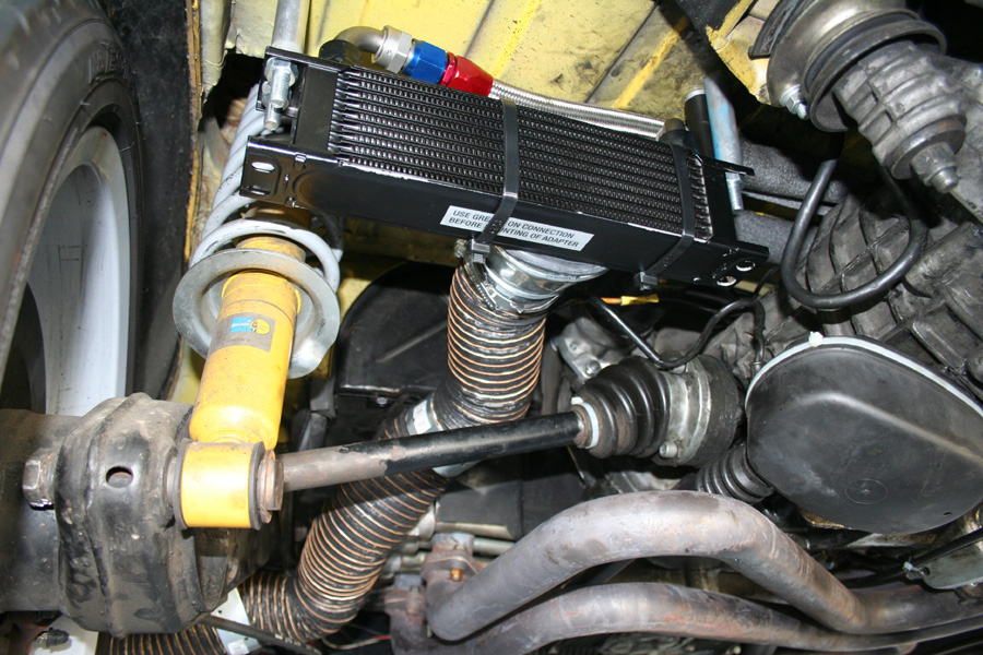

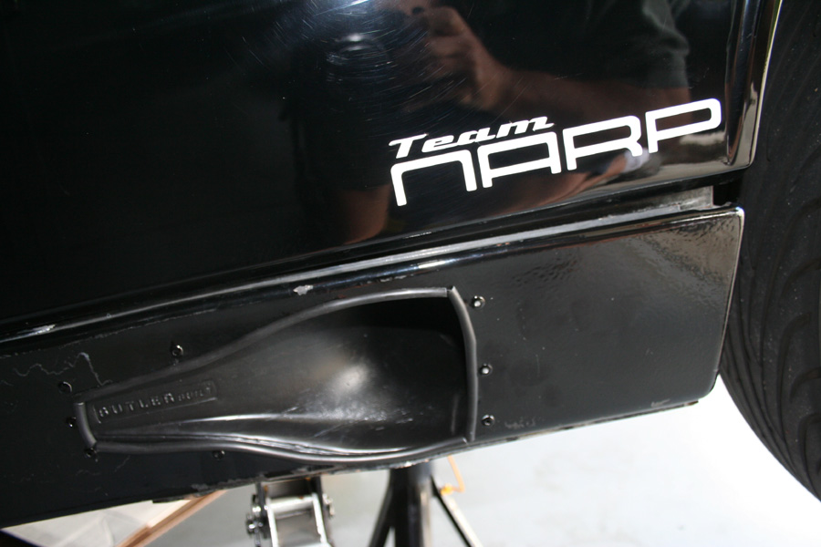

Start your car and put your hand down by the vents that go to the HEs and you will find a lot of cooling air goes out those vents. Definately block those off then drive the car and see if there is a difference. I have the same euro headers on a 2.2 liter type IV and I don't think they effect the oil temp much at all. I also use an aux. oil cooler under the rear trunk with the sandwich type adapter with thermostat. I duct cooling air from a scoop in the rocker panel to the cooler. It seems to work really well. 235 to 240 degrees is a bit much. Blocking off the vents is probably the easiest, cheapest thing to try and I would do that first.

Elliot Cannon   I got rid of the Home Depot scoop :barf: and made...   May 18 2010, 12:27 PM
