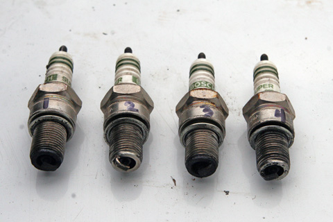

Decided to pull the spark plugs to check their condition.
#2 and #4 look good but #1 and #3 are extremely oily (IMG:style_emoticons/default/dry.gif)

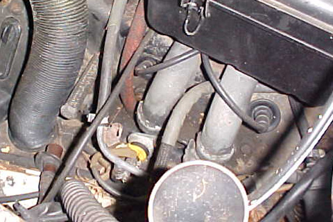

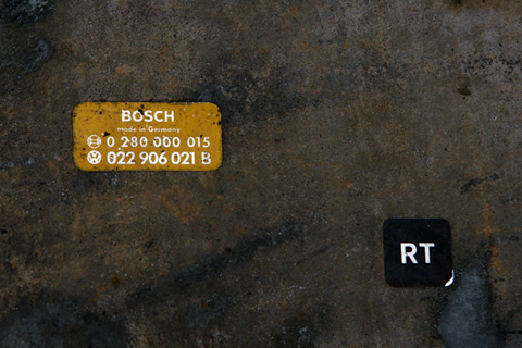

While looking at the ECU, something looked odd... no adjustment knob! So I removed it from its mount to check the model number. Grrrr, it's from a 1.7 as are the yellow injectors. (IMG:style_emoticons/default/hissyfit.gif)
I have an ECU & harness from a '73 2.0 but don't know the exact number since the tag is worn. Will either 022 906 021 AU or 022 906 021 EU work on the '74 which is 039 906 021 ?
Seeing the 1.7 FI parts got me worried so I pulled the MPS to check its number. Whew, it's an 043 (IMG:style_emoticons/default/smile.gif)
